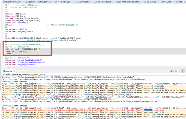

In the CLA, using the fminf/fmaxf functions triggers warnings but does not cause errors, and the functionality appears to work normally:
 "E:/workspace/git/1-215/dsp/KL_PCS_F28P65x_cpu1/src/module/control/INV/MBD/PWM_Gen/PWM_Gen.h", line 358: warning #225-D: function "fminf" declared implicitly "E:/workspace/git/1-215/dsp/KL_PCS_F28P65x_cpu1/src/module/control/INV/MBD/PWM_Gen/PWM_Gen.h", line 721: warning #225-D: function "fmaxf" declared implicitly

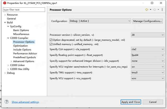

I tried adding preprocessor directives, as shown in Figure 1, but the warnings persist.
The compiler configuration is shown in Figure 2.
How can these warnings be resolved? Additionally, I am concerned that these warnings might cause issues under certain circumstances. I would appreciate an official explanation. Thank you!

  • Hi Dean,
    Thanks for your patience. It looks like you will need a #include to the CLAmath library in order to access these functions. See below screenshot of how you can do this.
    Ozino
  • Hi Ozino, thanks for your reply. this method indeed eliminates the warning, but I noticed that CCS actually recognizes #ifndef __TMS320C28XX_CLA__ #include <math.h>. However, my function is confirmed to run in the CLA, so it should include <CLAmath.h> instead of <math.h>. Wouldn't this cause issues during actual execution?

  • HI Dean,
    It should not cause any issues for any files that are due to run on the CLA. You can reference our C2000Ware and DigitalPower SDK examples to see the impact of running code on the CLA.
