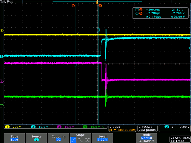

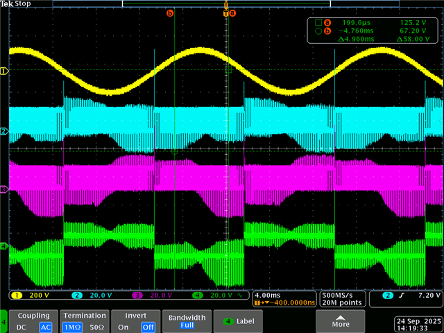

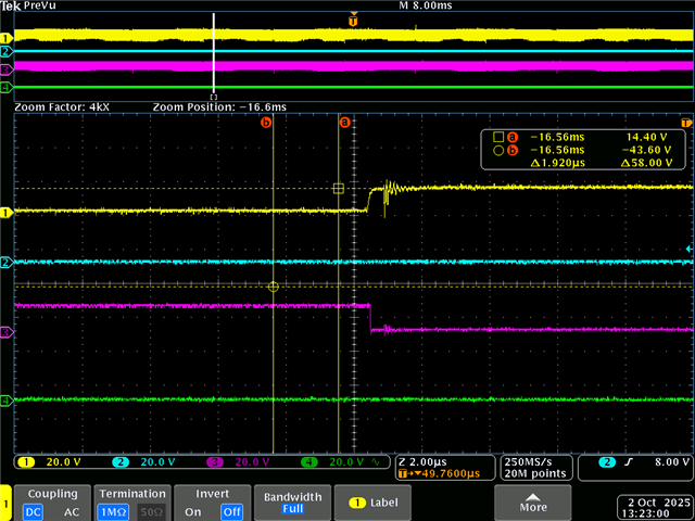

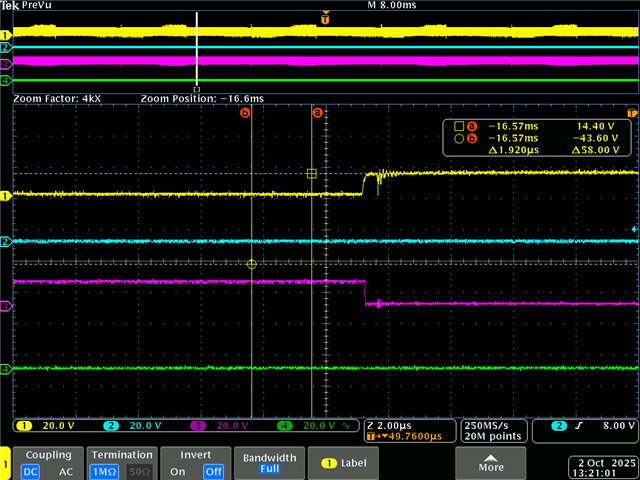

I am running some of tests on TIDM-HV-1PH-DCAC eval system. I ran this system as voltage source inverter in Open Loop mode. The system works as expected. However, I noticed that there are spikes on all 4 gate control signals (i.e. Q1.PWM, Q2.PWM, Q3.PWM, and Q4.PWM). I have a big concern on these spikes that may create the "shoot through" condition and damage the switching devices (MOSFET or IGBT). Can anyone explain why these spikes are present and how to suppress them if possible. The attached picture show the spikes probed on TP15 (ch2), TP16 (ch3), and TP20 (ch4) on the eval board. Thanks for any reply.

    Can you confirm if these noise are not picked by the probe? Are you using differential probe? Can you try measuring one Gate driver output at a time and check if noise is still there?

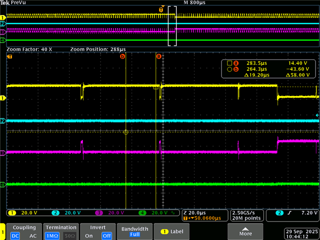

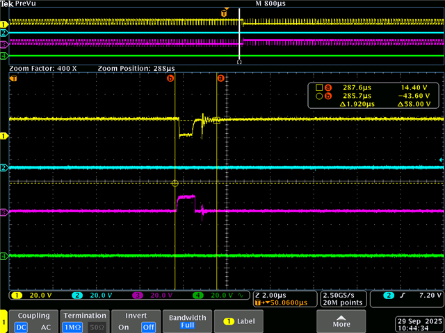

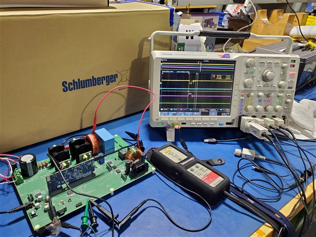

    I have used the differential probe to measure the output (i.e. Q1 PWM) of the driver controlling A leg of the bridge. The spikes are still there. Please see attached pictures for the spikes and the setup of differential probes to measure Q1 PWM output.
  • attached picture here:
    I used the differential probe on ch1 and single end probe on ch2 because I found only one differential probe. Thanks.

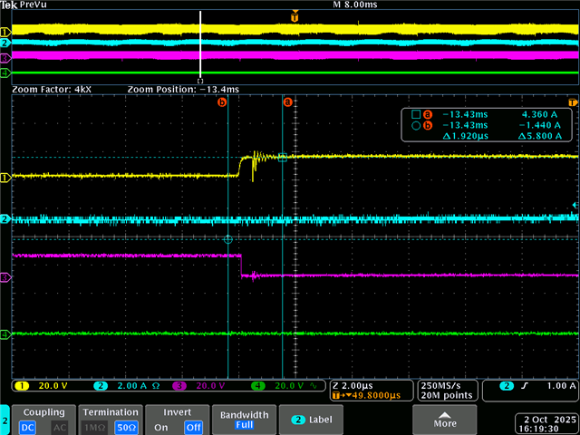

    I see the spikes are in the order of 100 of nano second. Do you see any current spike from the DC source. Do you also see increase in the magnitude of the spikes as you increase the DC input voltage?

    I tested the inverter system with different input DC voltages (200V and 300V). The spikes on the gate control signal Q1 PWM has no change in terms of amplitude. I don't have the current probe so can't check if there is current spikes on DC source. The picture on left has 200V of input DC. One on right has 300V DC. Thanks for your reply.

    Please check the current. If it does not have any spike, I would recommend to go ahead with you experiments.

    I checked the current spikes on DC source line and didn't see any spikes when the gate (Q1) signal has spikes. Ch2 is the current measurement on DC source. Now I feel more comfortable with more testing on this inverter system. Appreciate your helps.
  • Great. Good Luck for further testings.
