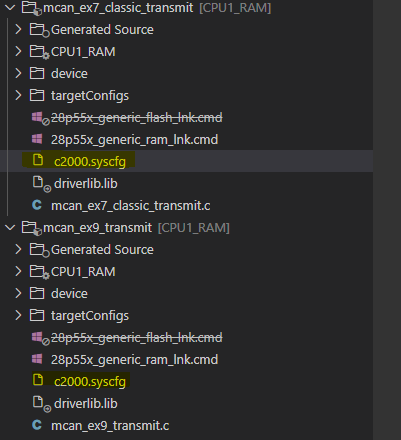

  • HI Sharath,
    Just imported two F28P55x MCAN example projects from C2000Ware_6x, the projects contain the the sysconfig file: c2000.syscfg:

  • I understood your question. It's very straightforward to use the sysconfig generated driver.
    Call the following functions in your main() function:
    1. Board_Init(),
    2.  Device_initGPIO()
    and  SysCtl_setMCANClock(...)
  • Just as a reference. It is not tested.

    Thanks for the response. Don't you think Board_Init() & other dependent functions were supposed to be added automatically by compiler or any tool itself?
    Sharath
  • Yes, the Board_Init() is generated by sysconfig.
