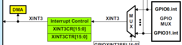

Question: How to get the value of each 16-bit counter? Can we use DMA? If yes, how to do this?
As we can see in the following picture (taken from pdf page 172), there seems to be DMA support.
Is it possible to transfer the 16-bit counter to RAM via DMA? If not, how to get the result, if the "accurately time stamp"
is reset on every interrupt edge? Please remember: no ISR can be used ...

    Apologies for the delay. The question you need answered here is: does XINT have DMA access? According to the below diagram, the answer is no since the DMA bus does not have a connection to the External interrupts. The XINT can however trigger a DMA channel, which I believe is why there is an arrow to DMA in the diagram you've shown.
    Can you explain the needs of your application more in depth and maybe I can offer a different suggestion? Also, have you looked into the eCAP module on this device? It can detect different rising/falling edge events on GPIO pins and could be used depending on what you are looking for.

    Apologies, I'm a little confused - is your question how to check this register value with the debugger since the firmware cannot be modified?
    By "occurring offline" do you mean with no debugger attached? Or you mean in the main loop so that no interrupts are triggered (I will assume this)?
    To read this counter value in the main loop, you can do a polling approach to continuously check the XINT interrupt flag. Once the flag goes high, you can read the correlating XINTx_CR register into a variable. Have you tried this in software? I'm assuming the counter itself shouldn't actually get cleared until the XINT conditional flag is cleared, however I'm not sure.
