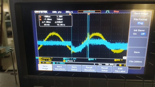

We are working on a 1-phase DC-AC grid-tie inverter using the F28069M LaunchPad () for a proof of concept (working with the TIDM-HV-1PH-DCAC reference design using the C2000Ware Digital Power SDK  5.01.00.00 (I'm running the gridConnectedInverterCLFltr_F2837x solution)).
  • In the First stage, we verified the inverter hardware section in open-loop configuration with a resistive load. The resulting output voltage was in phase with the grid voltage.
  • We introduced a single comparator-based protection for short circuit / over-current up to 2.7V (DAC value) in the unit. The target rating of the unit is 3 kW.
  • In the Second stage, we enabled the current loop by supplying DC (from a regulated DC source with a steady voltage). We observed the waveforms using an isolation transformer placed between the grid-tie inverter and the grid. This setup allowed us to analyze the output AC voltage and current waveforms up to a certain power level and gave us confidence in both the hardware design and the current loop algorithm.
  • The third stage involves pushing power directly to the grid. Here, with a small current reference (0.01) and 400 V DC supply for a 230 V, 50 Hz grid, we observed a current spike at the turn-on instant.
The sections we updated and verified include:
  • Loop frequency
  • Input DC voltage ( updated from 380V to 500V)
  • Output current reference ( Fixed reference during turn on condition, slow increase of current reference in loop)
  • Turn-on timing (considering relay mechanical delay of 7 ms to align with zero-crossing)
  • Operation above zero-crossing. ( matched the reference to turn on relay at different instants of sine wave).
  • LLC resonant frequency (for different hardware inductor values)
We also tested by increasing the DAC value of the comparator up to 3 V, which unfortunately resulted in unit failure.
We are attaching the PLL loop code snippet and snapshots of the output current spike waveforms for your reference. Kindly guide us on which section requires further updates or modifications to effectively control the transient current at turn-on and ensure smooth power delivery to the grid.
IMAGE1: grid Voltage, Output current spike.
Yellow - Grid voltage, Blue - output current.
(These waveforms are captured near micro pins).
IMAGE2: Yellow -Grid voltage, Blue - Output voltage.

  • Hello Manideep,
    From the details provided by you I assume that your hardware works with the isolation transformer but not directly with the grid. Did you try running the TI reference design in the same condition? I would recommend to do that. This way software and algorithm can be verified. Just for heads up, we only tested the TI board using grid emulator.
    The DAC comparator value depends what is your target value for the current protection.
    When you observe the spike, do you see the current protection triggering? I would suggest to analyze duty ratio, status of switches at the time of current spike and find the its root cause.
    Do you mean the board gets damaged by when you say unit failure?
