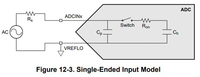

Hi experts,
My KMM AIWIN want to know where is the clamping diode set on ADC input
Leo

Hi Leo,
The block captured above for the ADC input is after ADC input mux switch which is in the ADC block. Clamp diodes are in the bond pads, close to the edge of the die.
Joseph
