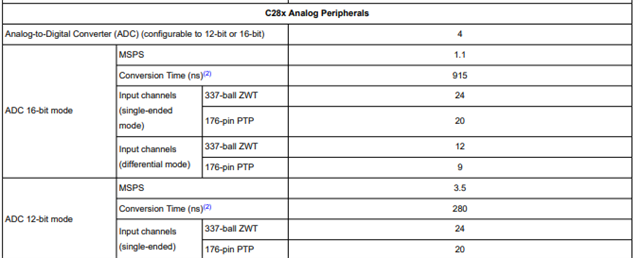

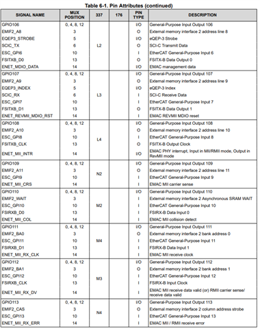

TMS320F28386D: Side-by-side function list of the PTP and ZWT
Part Number: TMS320F28386D
What functions are missing from the TMS320F28386D PTP version vs. the ZWT version. The datasheets are not formatted for inputting data into Excel to filter functions based on the two form factors.
