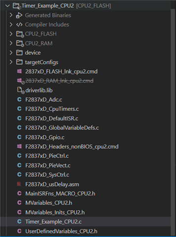

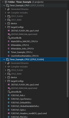

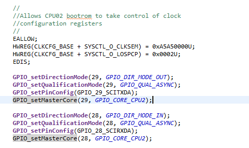

TMS320F28379D: CPU2 execution speed ~10x slower than CPU1 when running identical code from FLASH
Part Number: TMS320F28379D
I am running the same code on CPU1 and CPU2 of the F28379D, and both are configured to execute from FLASH. The code mainly generates three sine waves and runs a 3-Phase SRF PLL routine.
  • On CPU1, the SRF PLL routine takes about 140 Clock cycles.
  • On CPU2, the same routine takes about 1300 Clock cycles.
Setup details:
  • A 10 kHz timer interrupt triggers the execution on both CPUs - Timer0 in CPU1 and Timer1 in CPU2.
  • Inside the ISR, the code performs the sine-wave generation and runs the 3-Phase SRF PLL.
  • The exact same code is used on both CPUs.
Issue:
CPU2 is approximately 10× slower than CPU1, even though both are running from FLASH with the same code and ISR setup.
Question:
What could cause CPU2 to execute much slower than CPU1 when both are running identical code from FLASH? Are there any specific memory configuration or wait-state considerations for CPU2 when executing from FLASH?

    For CPU1
    • A 10 kHz timer (TIMER0) interrupt triggers the execution timer0_isr in CPU1.
    • And a 1 Hz timer (TIMER2) interrupt triggers the execution timer1_isr in CPU1.
    So, the entire code for CPU1 is as below.
    // Toggle GPIO pins 22,52 and 97 using timers
    // CPU1 controls GPIO 22 and 97
    // CPU2 controls GPIO 52
    // CPU1 uses Timer 0 and Timer 1 for toggling pins
    // CPU2 uses Timer 1 for toggling pin
    // Included Files
    #include "driverlib.h"
    #include "device.h"
    #include "UserDefinedVariables_CPU1.h"
    #include "MVariables_Inits_CPU1.h"
    #include "MVariables_CPU1.h"
    #include "MainISRFns_MACRO_CPU1.h"
    float32_t theta = 0.0f;
    float32_t Vm = 325.0f;
    //------------------------STRUCT VARIABLE-------------------//
    SRF_PLL Vgrid = SRF_PLL_DEFAULTS;
    __interrupt void timer0_isr(void)
        // Execute control algorithms
        // SET GPIO 22
        HWREG(GPIODATA_BASE + GPIO_O_GPASET) |= (uint32_t) 0x400000U;
        theta = theta + (TWO_PI * 50.0f * ISR_TIME_PERIOD);
        if (theta > TWO_PI) theta -= TWO_PI;
        Vgrid.Va = Vm * __cos(theta);
        Vgrid.Vb = Vm * __cos(theta-(TWO_PI / 3.0f));
        Vgrid.Vc = Vm * __cos(theta+(TWO_PI / 3.0f));
        Vgrid.Vab = Vgrid.Va - Vgrid.Vb;
        Vgrid.Vbc = Vgrid.Vb - Vgrid.Vc;
        SRF_PLL_MACRO(Vgrid);
        // CLEAR GPIO 22
        HWREG(GPIODATA_BASE + GPIO_O_GPACLEAR) |= (uint32_t) 0x400000U;
        // Cleanup
        // Clear flag in timer module (optional - but better to do this)
        HWREGH(CPUTIMER0_BASE + CPUTIMER_O_TCR) |= 0x8000U;
        // Clear ACK bit in PIEACK register
        HWREGH(PIECTRL_BASE + PIE_O_ACK) |= (uint16_t) 0x1U;
    __interrupt void timer1_isr(void)
        // Toggle GPIO 22
        HWREG(GPIODATA_BASE + GPIO_O_GPDTOGGLE) |= (uint32_t) 0x2U;
        // Cleanup
        HWREGH(CPUTIMER1_BASE + CPUTIMER_O_TCR) |= 0x8000U;
    // Main
    void main(void)
        // Initialize device
        Device_init();
        // Disable interrupts and clear them at the CPU
        // Initialize PIE module
        Interrupt_initModule();
        // Initialize PIE Vector Table
        Interrupt_initVectorTable();
        // Enable clock to Timer 0 and Timer 1
        EALLOW;
        HWREG(CPUSYS_BASE + SYSCTL_O_PCLKCR0) |= (uint32_t) 0x18U;
        EDIS;
        // Configure Timer 0 and Timer 1
        // Stop the timers
        HWREGH(CPUTIMER0_BASE + CPUTIMER_O_TCR) |= (uint16_t) 0x10U;
        HWREGH(CPUTIMER1_BASE + CPUTIMER_O_TCR) |= (uint16_t) 0x10U;
        // Load the period value
        // Timer 0 = 100 micro-sec interval - (20000-1)
        // Timer 1 = 1 sec interval
        HWREG(CPUTIMER0_BASE + CPUTIMER_O_PRD) = 20000-1;
        HWREG(CPUTIMER1_BASE + CPUTIMER_O_PRD) = 200000000-1;
        // Load optional pre-scale value
        HWREGH(CPUTIMER0_BASE + CPUTIMER_O_TPR) = 0x00;
        HWREGH(CPUTIMER1_BASE + CPUTIMER_O_TPR) = 0x01;
        // Set the mode of running
        HWREGH(CPUTIMER0_BASE + CPUTIMER_O_TCR) |= (uint16_t) 0x0800U;
        HWREGH(CPUTIMER1_BASE + CPUTIMER_O_TCR) |= (uint16_t) 0x0800U;
        // Enable Timer Interrupts
        HWREGH(CPUTIMER0_BASE + CPUTIMER_O_TCR) |= (uint16_t) 0xC000U;
        HWREGH(CPUTIMER1_BASE + CPUTIMER_O_TCR) |= (uint16_t) 0xC000U;
        // Reload period and prescale
        HWREGH(CPUTIMER0_BASE + CPUTIMER_O_TCR) |= (uint16_t) 0x0020U;
        HWREGH(CPUTIMER1_BASE + CPUTIMER_O_TCR) |= (uint16_t) 0x0020U;
        // Register ISRs for Timer 0 and Timer 1
        Interrupt_register(INT_TIMER0, &timer0_isr);
        Interrupt_register(INT_TIMER1, &timer1_isr);
        // Configure the PIE module for Timer 0 - INT1.7
        HWREGH(PIECTRL_BASE + PIE_O_IER1) |= (uint16_t) 0x40U;
        // Enable the global interrupts and configure IER
        // Enable Timer 0 Interrupt
        IER |= 0x01U;
        // Enable Timer 1 Interrupt
        IER |= 0x1000U;
        EINT;
        // Configure GPIO pins 22, 52 and 97
        EALLOW;
        // Pin 22
        HWREG(GPIOCTRL_BASE + GPIO_O_GPAMUX2) &= 0xFFFFCFFFU;
        HWREG(GPIOCTRL_BASE + GPIO_O_GPADIR) |= (uint32_t) 0x400000U;
        // Pin 52
        HWREG(GPIOCTRL_BASE + GPIO_O_GPBMUX2) &= 0xFFFFFCFFU;
        HWREG(GPIOCTRL_BASE + GPIO_O_GPBDIR) |= (uint32_t) 0x100000U;
        HWREGH(GPIOCTRL_BASE + GPIO_O_GPBCSEL3) |= (uint32_t) 0x2000U;
        // Pin 97
        HWREG(GPIOCTRL_BASE + GPIO_O_GPDGMUX1) &= 0xFFFFFFF3U;
        HWREG(GPIOCTRL_BASE + GPIO_O_GPDDIR) |= (uint32_t) 0x2U;
        EDIS;
        // Start the Timers
        HWREGH(CPUTIMER0_BASE + CPUTIMER_O_TCR) &= 0xFFEFU;
        HWREGH(CPUTIMER1_BASE + CPUTIMER_O_TCR) &= 0xFFEFU;
        // Infinite loop
        while(1){}
    // End of File

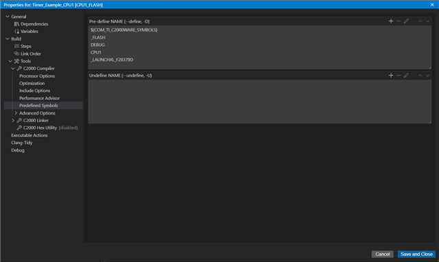

    with the pre-defined symbols in the CPU1 project properties, as shown in the picture below
    CPU1 project - Build configurations
    CPU1 project files.
    For CPU2
    • A 10 kHz timer (TIMER1) interrupt triggers the execution timer1_isr in CPU2.
    So, the entire code for CPU2 is as below.
    // Included Files
    #include "F28x_Project.h"
    #include "device.h"
    #include "UserDefinedVariables_CPU2.h"
    #include "MVariables_Inits_CPU2.h"
    #include "MVariables_CPU2.h"
    #include "MainISRFns_MACRO_CPU2.h"
        // SET GPIO 52
        GpioDataRegs.GPBSET.bit.GPIO52 = 1;
        // CLEAR GPIO 52
        GpioDataRegs.GPBCLEAR.bit.GPIO52 = 1;
        // Cleanup
        CpuTimer1Regs.TCR.bit.TIF = 1;
    // Main
    void main(void)
        InitPieCtrl();
        IER = 0x0000;
        IFR = 0x0000;
        InitPieVectTable();
        // Enable clock to Timer 1
        EALLOW;
        CpuSysRegs.PCLKCR0.bit.CPUTIMER1 = 1;
        EDIS;
        // Stop the timers
        CpuTimer1Regs.TCR.bit.TSS = 1;
        // Timer 1 = 100 micro-sec interval - (20000-1)
        CpuTimer1Regs.PRD.all = 20000-1;
        CpuTimer1Regs.TPR.all = 0;
        CpuTimer1Regs.TCR.bit.FREE = 1;
        CpuTimer1Regs.TCR.bit.TIE = 1;
        CpuTimer1Regs.TCR.bit.TRB = 1;
        EALLOW;
        PieVectTable.TIMER1_INT = &timer1_isr;
        EDIS;
        IER |= 0x1000U;
        EINT;
        // Start the Timers
        CpuTimer1Regs.TCR.bit.TSS = 0;
        // Infinite loop
        while(1){}
    // End of File
    with the pre-defined symbols in the CPU2 project properties, as shown in the picture below
    CPU2 project - Build configurations
    CPU2 project files.

    Apologies again for the delay. One thing that comes to mind is the ownership of GPIO22, only one CPU can have ownership of a GPIO at a time. Can you try using a different GPIO for CPU2 like below and see if that solves the issue?
    We have an example in C2000ware showing a GPIO toggling on both CPU1 and CPU2 (path below). Can you check that your code follows the same steps to initialize the GPIOs on each core?
    [C2000ware install]/driverlib/f2837xd/examples/dual/led/led_ex1_blinky_cpu1 & led_ex1_blinky_cpu2
