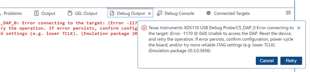

Hi Sayali,
CCS is not able to connect to the onboard debugger on your LaunchPad. What CCXML file are you using? Is it configured for 4-pin JTAG?
Peter
