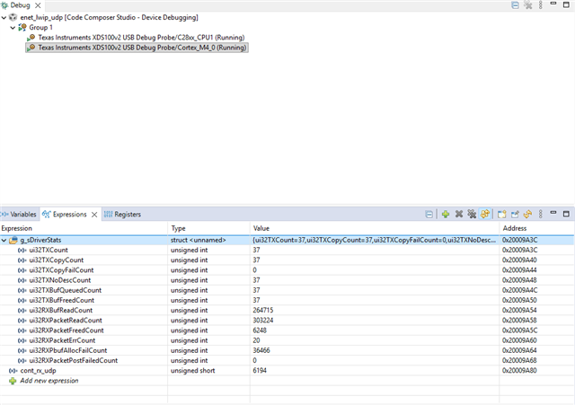

I am using the latest C2000Ware v6.00.00.00 SDK on an F2838x device.
Setup:
  • Example: enet_lwip_udp.c on CM core
  • Companion: ethernet_ipc_ex1_basic_c28x1.c on C28x1
  • Monitoring g_sDriverStats
Problem:
When stressing the system with high UDP traffic, ui32RXPbufAllocFailCount increases. Once this happens, the RX path stops working completely — the device no longer receives UDP packets until a full reset.
Debug findings:
  • The lwIP PBUF_POOL fills up and is never recovered.
  • Once exhausted, all functions that require new pbufs stop responding.
  • Driver code should recycle or free buffers but does not, leading to a permanent stall.
Reproduction:
  • Run stock SDK examples.
  • Flood UDP with a simple script (example: Python udp_flood_1.py with 40-byte payloads, 4 threads, 10 s duration).
  • Observe g_sDriverStats.ui32RXPbufAllocFailCount rising. RX stops after exhaustion.

  • Screenshot of g_sDriverStats showing counter increase.
  • UDP flood script used for testing (udp_flood_1.py).
