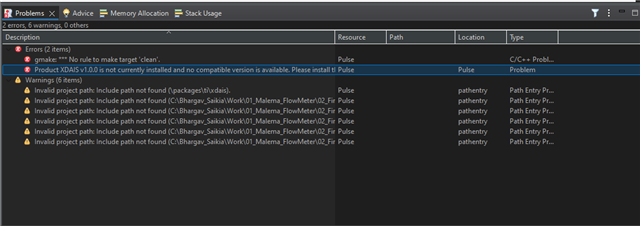

I am getting this error "Error while importing and compiling legacy CCS v3.3 source code. Product XDAIS v1.0.0 is not currently installed and no compatible version is available. Please install this product or a compatible version.' while importing and building a legacy CCS v3.3 project in CCS v12.8 version. As per online suggestion, there is a 'Product' Tab inside Properties -> General, where we can uncheck the XDAIS. Maybe this was available in older versions of CCS but I am no longer able to see this option in CCS v12.8. Can you please support to fix this issue? Attached screenshot of error.
