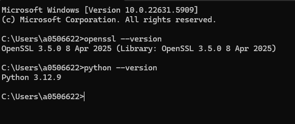

  • Hi Andrew,
    This would occur for 2 reasons.
    1. OpenSSL not installed
    2. Python not installed.
    Can you share me the screenshot of the below 2 commands
    1. openssl --version
    2. python --version
    Thanks and Regards,
    Nikhil Dasan
  • Hi Nikhil,
    You can find version details below:
