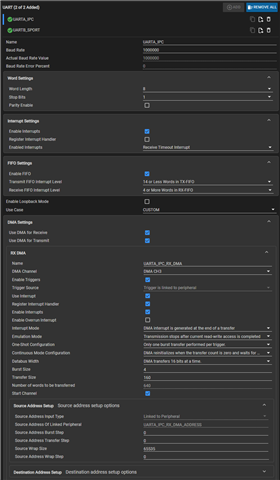

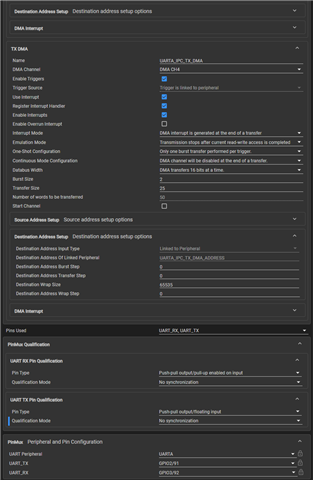

TX is driven by a DMA -- burst size 2, triggered by 14 bytes or less in the TX FIFO. The DMA is set up to send the entire transfer in one operation.
RX is also driven by a DMA -- burst size 4, triggered by 4 or more bytes in the RX FIFO. The DMA runs continuously, and the buffer is large enough to fit an entire message. I can see that we're receiving spurious zeroes by observing the buffer with a debugger.
I could use some help figuring out what could be causing this behavior. Since the TX DMA's burst size is 2, it shouldn't even be possible to send an odd number of bytes -- but the logic analyzer clearly shows that we are occasionally sending 519 instead of 520. I would appreciate any insight.

  • Thank you for looking into it!
    1. I have reproduced the issue with the UARTRIS register reporting no errors. I did see the overflow bit set once when I abused the unit by starting and stopping the debugger a bunch, so it looks like everything is set up right and the interrupt bits are not accidentally being cleared somewhere.
    I also checked UARTRSR and the DMA channel's OVRFLG bit, and they look ok.
    2. Thank you. I have not been looking at UARTDR with the debugger.
    3. We started with examples. Everything has been working somewhat reliably until recently, when we started doing larger (ie, 520-byte) transfers.
    I also just noticed something similar on the second UART, which we are also using for inter-device communication. That UART is transmitting at 8.33MHz, and I'm occasionally noticing four bytes missing in the middle of 46-byte transmission. I'm not sure if this is new or if we just didn't notice until now; I can look into it next week.
    I find these symptoms very strange. If the DMA were too slow (contending for resources with other DMA channels / the CPU, missing triggers, etc), I would expect to see gaps in the transmission but no missing data. Instead, it transmits with no gaps but still misses a byte. Is it possible that the DMA is instead doing two bursts for one trigger?
    On the RX side, my current theory is that the UART FIFO is underflowing -- ie, the DMA tries to retrieve a byte from an empty FIFO, which results in an extra zero in the DMA buffer. Would an underflow set any of the error bits? I'm struggling to figure out where else that zero could possibly come from.
