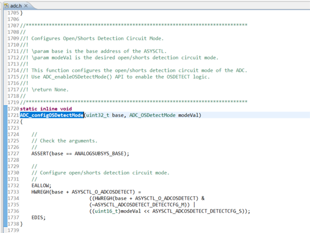

  • This is code for configOSDetectMode in adc.h for f28p55x
    C2000Ware v6.00.00.00
    How will the ADC and AnalogSubsystem configuration change here ??
    Can you share me updated code for this.
  • Sorry, I didn't realize that F28P55x had a slightly different structure for the OSDETECT.
    It looks like the difference is that the OSDETECT is part of AnalogSubsystem and shared between the ADC instances. So you use ADC_configOSDetectMode which looks pretty much the same except it takes the ANALOGSUBSYS_BASE base address. There's also a separate enable/disable bit so you'll need to use ADC_enableOSDetectMode and ADC_disableOSDetectMode.
    Finally there's a function called ASysCtl_setAnalogReferenceB which seems to select which instance the OSDETECT circuit gets connected to. According to the TRM, the ASYSCTL_TESTANA1_ENABLE option should be used for the modeVal parameter when using OSDETECT. You can then set it back to ASYSCTL_TESTANA0_TESTANA1_DISABLE when you're done.
    I'll find some time early next week to try it out myself and update you, but I wanted to share the info now in case you wanted to see if you could get it working before then.
    Whitney

        EALLOW;
        HWREGH(ANALOGSUBSYS_BASE + ASYSCTL_O_ADCOSDETECT) |= ASYSCTL_ADCOSDETECT_OSDETECT_EN;
        HWREGH(base + ADC_O_CONFIG2) = 0x2U;
        EDIS;
    //! Disables Open/Shorts Detection Circuit logic.
    //! \param base is the base address of the ASYSCTL.
    //! This function disables the open/short detection circuit logic.
    //! \return None.
    static inline void
    ADC_disableOSDetectMode(uint32_t base)
        // Check the arguments.
        ASSERT(ADC_isBaseValid(base));
        // Disable open/shorts detection circuit.
        EALLOW;
        HWREGH(ANALOGSUBSYS_BASE + ASYSCTL_O_ADCOSDETECT) &= ~ASYSCTL_ADCOSDETECT_OSDETECT_EN;
        HWREGH(base + ADC_O_CONFIG2) = 0x0U;
        EDIS;
    asysctl.h:
    //! Configure the analog reference B.
    //! \param adcInst is the instance of the ADC.
    //! \param modeVal is the desired ADC Test Mux mode.
    //! This function configures the analog reference B for ADC. The \e modeVal
    //! parameter selects which mode needs to be configured for the desired
    //! \e adcInst. Valid values for \e modeVal can be referred from the enum
    //! \e ASysCtl_ADCTestMuxMode.
    //! \return None.
    static inline void ASysCtl_setAnalogReferenceB(ASysCtl_AdcInst adcInst,
                                                    ASysCtl_ADCTestMuxMode modeVal)
        uint32_t shiftVal;
        shiftVal = adcInst + ASYSCTL_REFCONFIGB_ADC_ATB_ENA_S;
        EALLOW;
        HWREG(ANALOGSUBSYS_BASE + ASYSCTL_O_REFCONFIGB) =
                        (HWREG(ANALOGSUBSYS_BASE + ASYSCTL_O_REFCONFIGB) &
                        ~((uint32_t)0x3 << shiftVal)) |
                        ((uint32_t)modeVal << shiftVal);
        EDIS;
    We'll get these fixed in a future C2000Ware release.
