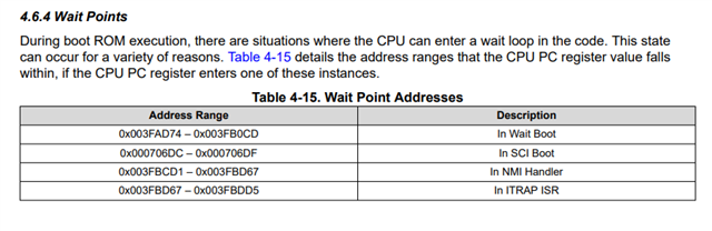

    It looks like the device is currently in an ITRAP ISR:
    Source: TRM
    Are you able to connect to the device successfully, view the memory contents (in the memory browser), and check if the program was successfully programmed?

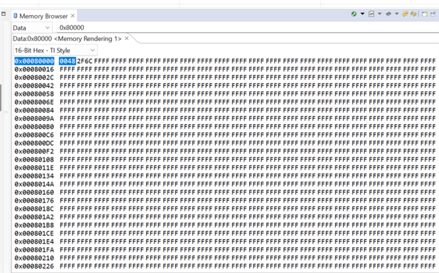

  • Hello Matt, thanks for the quick reply. I can not view the memory content. The memory browser does not show anything.

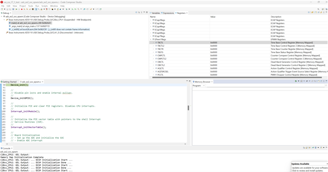

  • That is what I see when I try to start the program:
    Please type in the address in the memory browser, with the "Data" option configured in the drop down.
    Can you debug/step through the application and see what triggers the ITRAP?

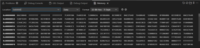

  • Hello Matt, that is what I see at 0x80000
    It looks like the codestart for the application was programmed correctly.
     Can you try stepping through your code (make sure not to step into the function calls) and see what line causes the error?

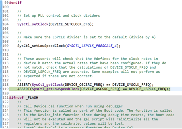

  • Hello Matt, I think we are close to the problem: On my hardware I used an external 50MHz clock oscillator pin 69 / X1 instead an quartz oscillator: Since I got the clock from another hardware part I didn't check it. Below you see at which function call I get into trouble. Is it possible to configure the µC to either an external 50MHz oscillator or just on the internal oscillator. I didn't find this in the system configuration.
    I think the 50MHz clock on X1 is the problem. As per the datasheet, X1 can only accept 2-20MHz from an external oscillator.
    Matt
  • To follow up:
    If you want to change the OSCCLK source to INTOSC2 (10MHz) and configure the SYSCLK for 100MHz, please change the following lines in device.h.
    Matt
