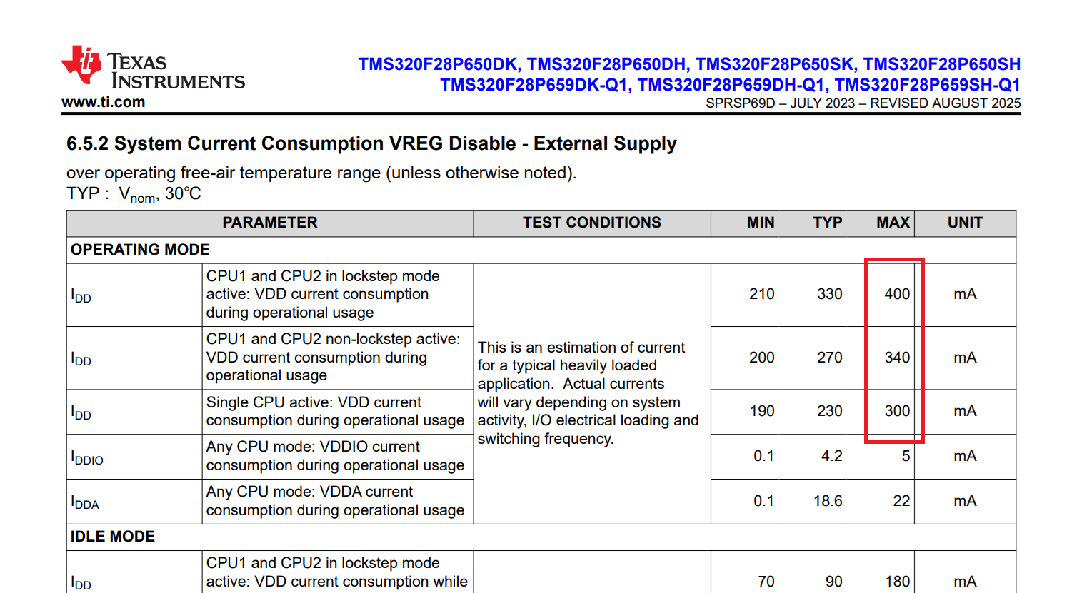

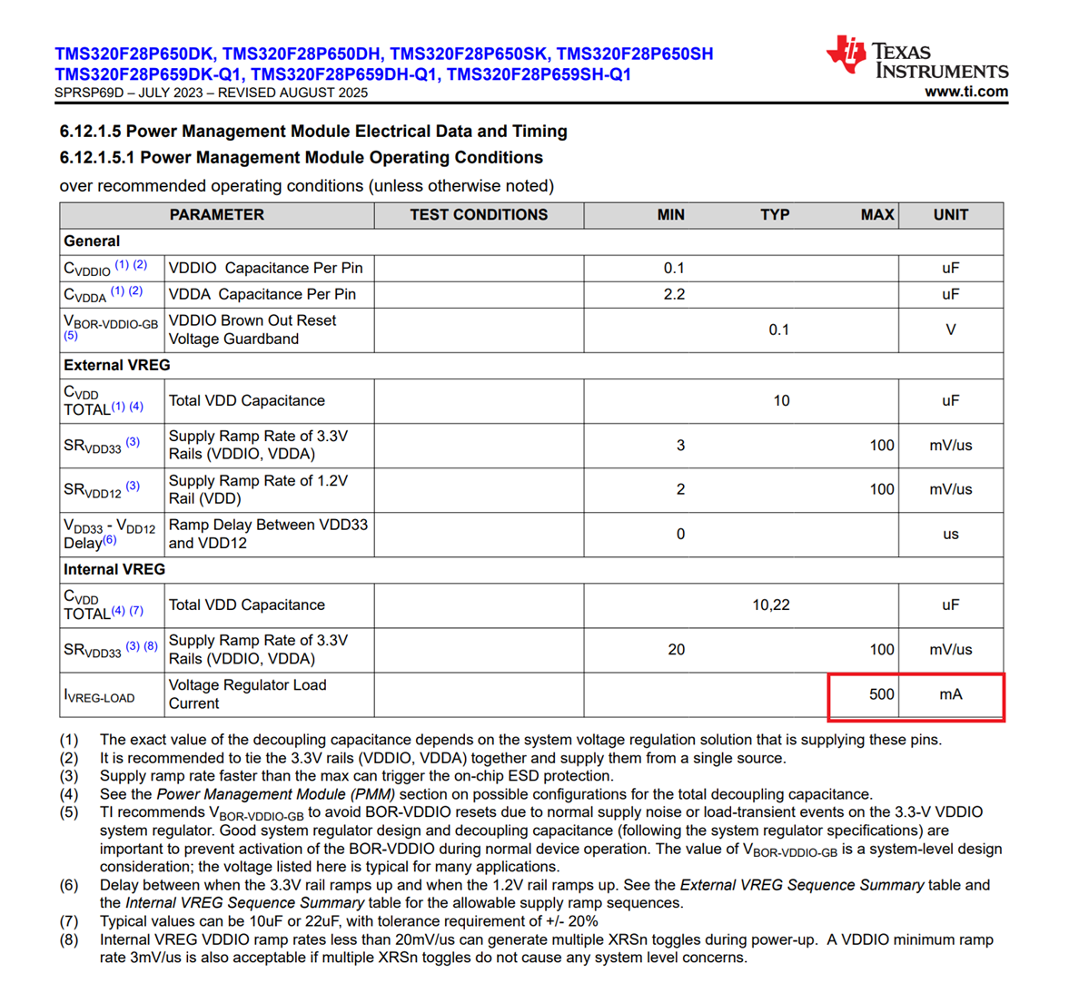

1) From the image below from the datasheet, it shows 500 mA for voltage load current.
Does this mean Idd 1.2V current maximum?
2. Based on the table below from the datasheet, Idd current max for dual-core CPU1/CPU2 are still below 500 mA, so the on-chip VREG is sufficient for dual-core F28P650Dx.
The user can just the on-chip VREG (VREGENZ=VSS) for F28P650Dx.
Is our understanding correct?
