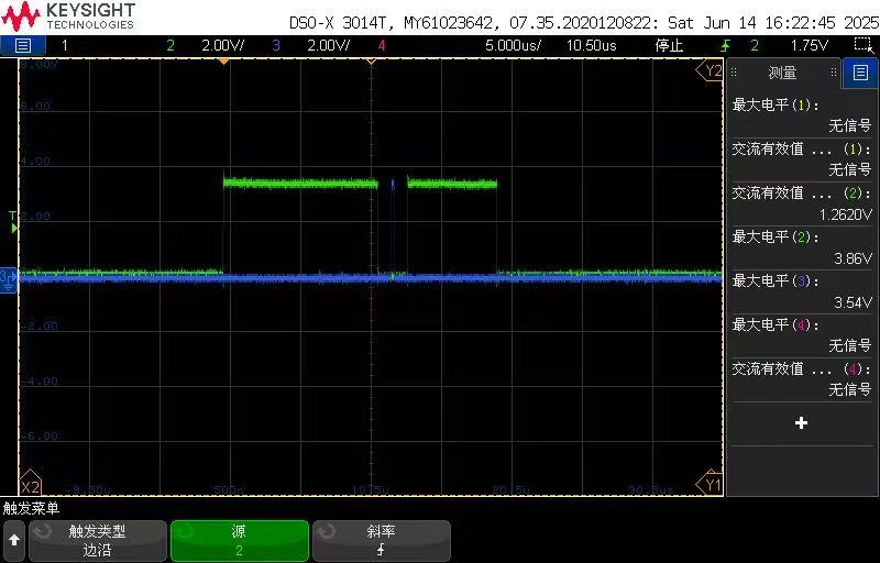

TMS320F28027: Using DB with DBRED/DBFED larger than the duty.
Part Number: TMS320F28027
Hi Experts,
My cusomter using DB with a small duty in the PWM. They are seeing the below behaviour:
Green: EPWMA
Blue: EPWMB
  1. The duty cycle is small, with the DB delays in blue FED and greed RED, you may see the blue have a very short high-time, this is expected 1015988957.jpg
  2. Now, they further reduce the duty of the raw input that the DBFED and DBRED is equal / larger than the duty. They expect the high-time of the blue would futher reduce and may reduce to none, however what they see is like below70993815.jpg
Could you pleaes help explaining this behaviour?
We are guessing that it's the DB delay that changes the order of the edges. For example, the blue should first have a rising edge then a falling edge, however, the rising edge is delayed by DB so that the falling edge would come fisrt. Iit's this possible?
I am also attaching the PWM configuration here:
