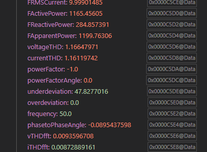

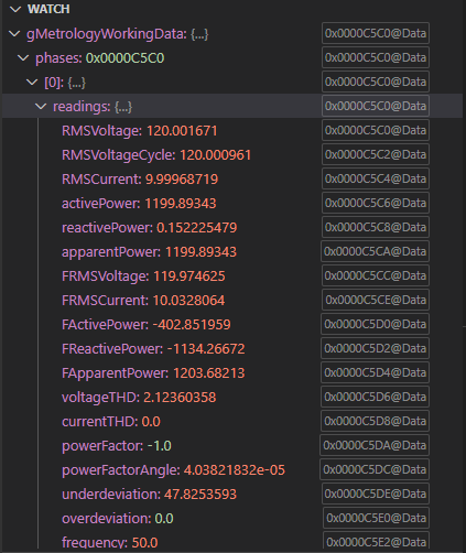

3. Where can I see my Meterology Parameters values?
Once you have succesfully built the CCS project with the E-meterology Library, right-vlivk on the project and select Debug Project. Load the program on C28xx_CPU1.

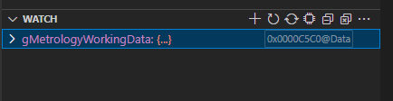

Once you have loaded the program, go to the Watch window and click on "+" option to Add Expression. Add gMeterologyWorkingData variable to the Watch space.
Under that you can choose the phase you want to monitor, and then click on readings. Make sure to enable continuous refresh option. Now you can click on "continue" and you can observe the changing parameter values.
