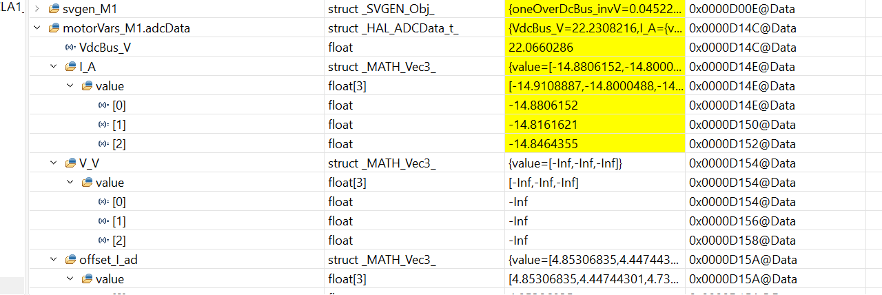

Hi team,
Now my customer using BSXL3PHGAN driver configuration to driver the BSXL3PHGAN successfully, and they want to change the BSXL3PHGAN to DRV8316T(non-SPI)
And they don't want to change the driver, so I try to using the same BSXL3PHGAN driver but change the hardware pin connection.
For BSXL3PHGAN, it connects the PWM to INHx/INLx, ADCINx to Udc, Uphase and Iphase, MTR1_GATE_EN_GPIO to enable pin, MTR1_PM_nFAULT_GPIO to OT.
For DRV8316T, I connect the corresponding pin(setted in hal.h) between F280039 Launchpad and DRV8316T EVM(EPWM--> INHx and INLx, ADCINx --> VSENx, ADCINx --> ISENx, ADCINx --> Vdc, MTR1_GATE_EN_GPIO --> DRVOFF)
Set the DMC_BUILDLEVEL to DMC_LEVEL_2, the outA of DRV8316T can output EPWM successfully, the waveform has the same phase with the EPWM output of F280039, but the current/voltage offset is uncorrect
Then I set the DMC_BUILDLEVEL to DMC_LEVEL_1 and run the runMotor1OffsetsCalculation(), and use the value in motorHandle_M1 update to below variable, but the result still uncorrect
Could you tell me how to set the offset of Iphase and Uphase and scale factor of the sample signal?
