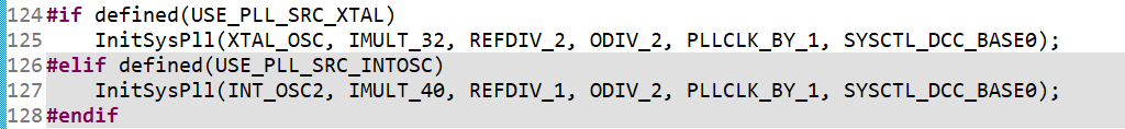

I ask this for my customer, now they meet below issue when development. We are using the bit fields example code.

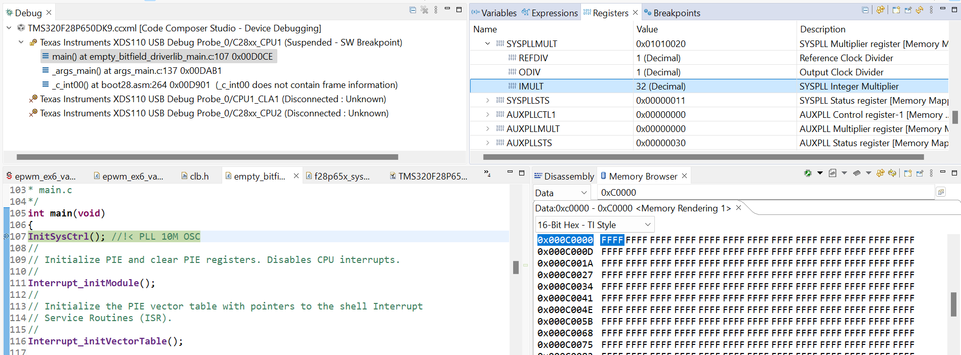

1.Why do the SYSPLLMULT registers have values before main() runs? I saw in the TRM that their reset value is 0. When are these values written to the registers? Below is the display from my Launchpad. The register values read on the customer's board are IMULT=40, REFDIV=1, ODIV=2, which is the same configuration as when using INTOSC.
2. Since the SYSPLLMULT register has a value before the PLL is initialized by below code
, and the customer is using an external 10MHz XTAL, if the customer uses the same IMULT, ODIV and REFDIV as the internal oscillator, it will cause the code to fail to update the oscillator source to XTAL.

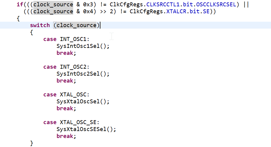

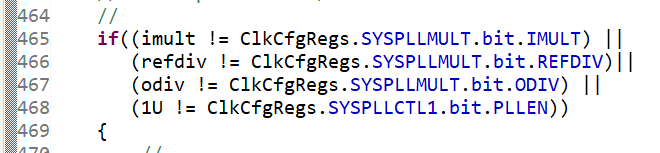

This is because in InitSysPll() there is a judgment as below:
If all the values that need to be checked inside if() are the same as the values currently set by the customer, then the contents inside if() will be skipped and else() will be executed directly. But switch the clock_source code is inside if(). This causes the clock_source switch to fail.

    I use LaunchPad and you can check below video. You can see that when I connect to CPU1, SYSPLLMULT has a value, and clicking CPU reset does not clear this value. After I load the .out file, you can see that this value is being updated. In short, the initial value of this SYSPLLMULT register is not 0. You should be able to reproduce this if you test it with code.

    1. Your assumption about the function line no. 465 in f28p65x_sysctrl.c is correct. The way code is written now, it would skip the PLL clk configuration (switch clock source) and it would start-up with inherited  PLL initialization and registers based on Boot-ROM programmed code.

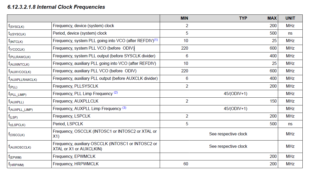

    2. I took another look at your coefficients, and these coefficients would not work based on the Internal clock frequencies table from TRM that you have attached.
    Please tell them to refer to the Figure 3-10 from TRM
