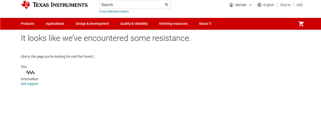

  • We're using Visual Studio. Are there some examples on sending/receiving data via UART?
    I'm getting this error when trying to download the GUI
  • Hi Mike,
    I'm still a little bit confused. Are you using a GUI powered by Visual Studio (if so, what is it called)? If you are looking to interface with UART/USB via a python script run in visual studio I can help with that? Please help me understand the details better.
    I have checked and apparently there is something wrong with the download link for this currently. I have the exe file and I can send it to you through E2E DM. I have sent you a friend request.
