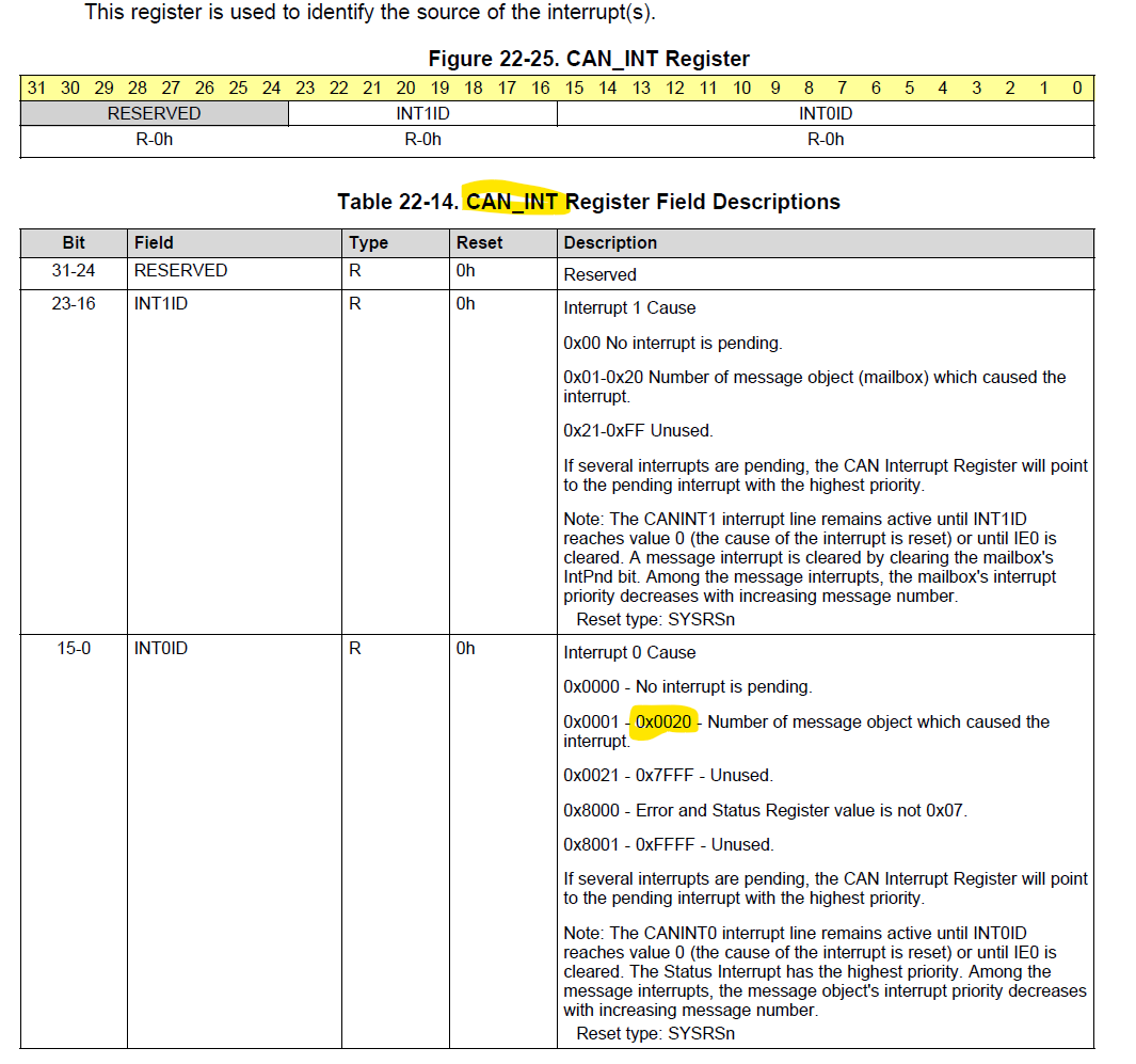

    In our system, the can stack processing only one msg numer (see CAN_INT register number of message 1-32) at the same time. The received msg is only in one mailbox, either (in our case for rx) 2 or 32. Configured is 1(tx) and 2-32(rx).
    When interrupt (CAN_INT hw register, see description in our previous msg above) signals msg 0, this means no real interrupt pending (no msg). So, we have not really 33 mailboxes, but only 1-32 (see manual too).
    Can handling is done in our application only via cpu1. We are using CAN module A.
    So, the main question is still, why do we got interrupts with msg id 32 (is this a fault?), and not for example msg id 3.

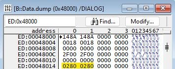

  • Hi Stefan,
    In test mode, you can access directly the message RAM.
    1. Set "TEST" bit of "CAN_CTL" register to enable the TEST mode
    2. Set "RDA" bit of CAN_TEST register to enable the direct access to the message RAM
    I changed two registers directly from the memory browser:
    CTL at 0x48000: 0x1401 -->0x1481 to enable TEST mode
    TEST at 0x48014: 0x0080 --> 0x0280 to enable RDA
    3. In CCS, open the memory browser
    Teh 1st message object is located starting at offset 0x20, the 2nd message object at 0x40. The last message object (#32) will be written to the very begining starting at 0x00 (offset)

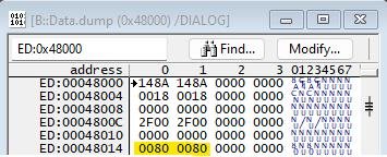

  • Hi QJ,
    Thank you for the detailed information.

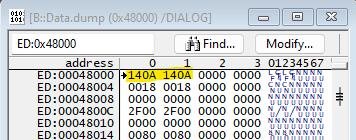

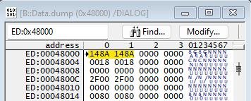

    First I set the "TEST" bit of "CAN_CTL" register to enable the TEST mode:
    Afterwards I set the "RDA" bit of CAN_TEST register to enable the direct access to the message RAM:

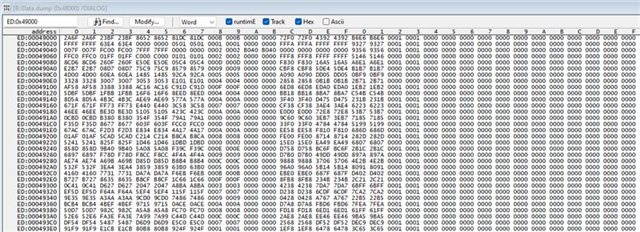

    The 0x49xxx values are as following (I can only see words with my debugger):
    Do you see here something that is not right or everything is as it should be?
    Do you need more information or can you already tell me why sometimes the messages land in the message box 32?

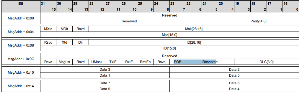

  • The last screenshot is not clear. I noticed that all the mailbox has two bytes of data (at 0x10, 0x11), is it true? For mailbox 32 (at 0x4900), the RmtEn is set (bit 9 at 0x0E offset). You can check the status and settings of your mailbox 32 using the table below as a reference.
