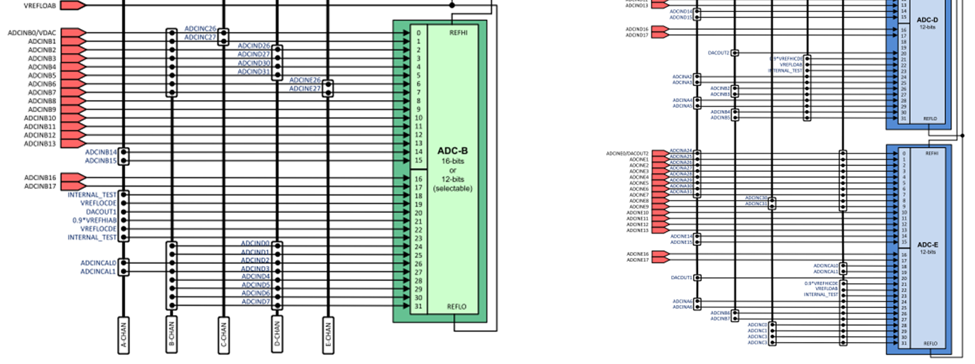

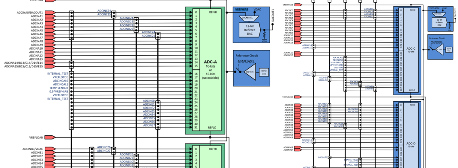

Regarding the ADC section, the CDE group shares a power supply, and the description mentions a 12-bit and 16-bit configuration, as shown in the image below.
However, in the ADC block diagrams of the later units, the CED groups do not have the same 16-bit or 12-bit selection instructions as the A and B groups. Which one is correct?
