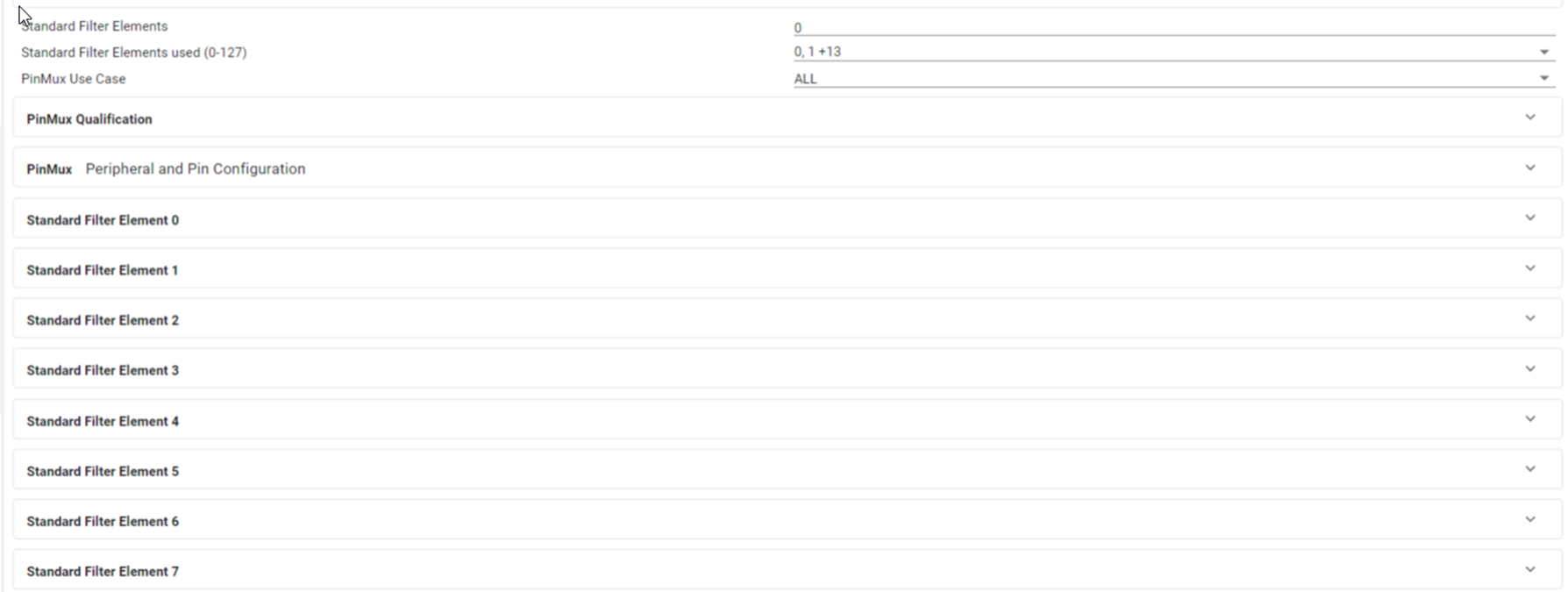

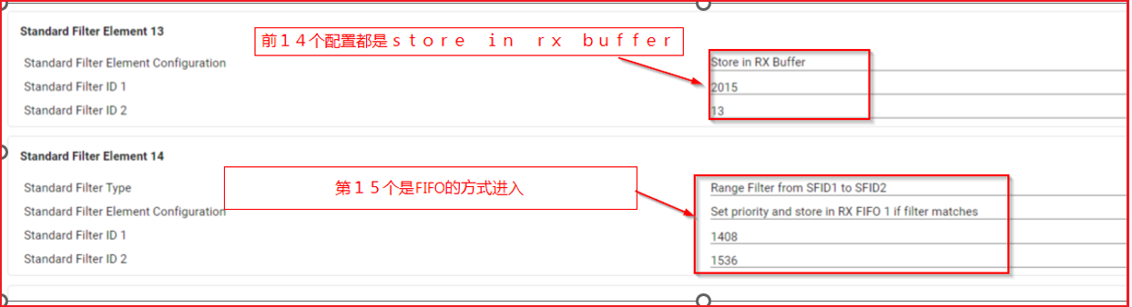

4. Customer try to use sysconfig to realize the CAN range filter
And they set below:
they use filter element 14 to realize the range fliter and store the data to FIFO, but they finds if they set the opreation mode to overwrite mode, it can receive the data; but if they change it to blocking mode, they just can receive one message frame. Could you help to check this? Is any other opreation needed to do if they use blocking mode? I compare the ISR operation between their code and mcan_ex8_range_filter_receive demo ISR code, don't find any difference

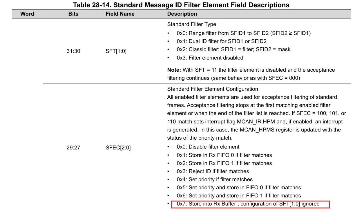

    The range filter is only for FIFOs.
    To store the message to a dedicated RX buffer, SPEC=0x7 and SFID2[10:9]=0x0 should be configured. The SFID[5:0] is the offset of the RX buffer start address

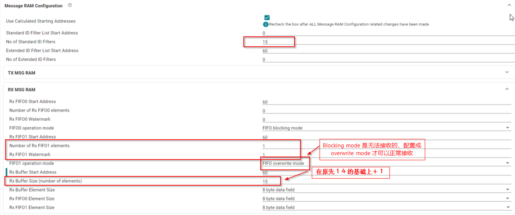

    I want to develop a demo based on sysconfig, that is use data bit switching, standard filter: mcan_ex8_range_filter_receive_syscfg.zip
    But I just can receive the first two frame, and can't receive the correct frame ID, could you help to check this?

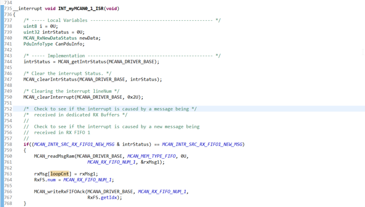

  • Hi Shuqing,
    I noticed that the SDK API MCAN_readMsgRam() can not be used directly to read FIFO. You need to write another function to check the index and fill level, then use this API to read all the buffers from the FIFO.
    I re-wrote the function for MCAN FIFO read. I haven't got chance to test it. Please try it.

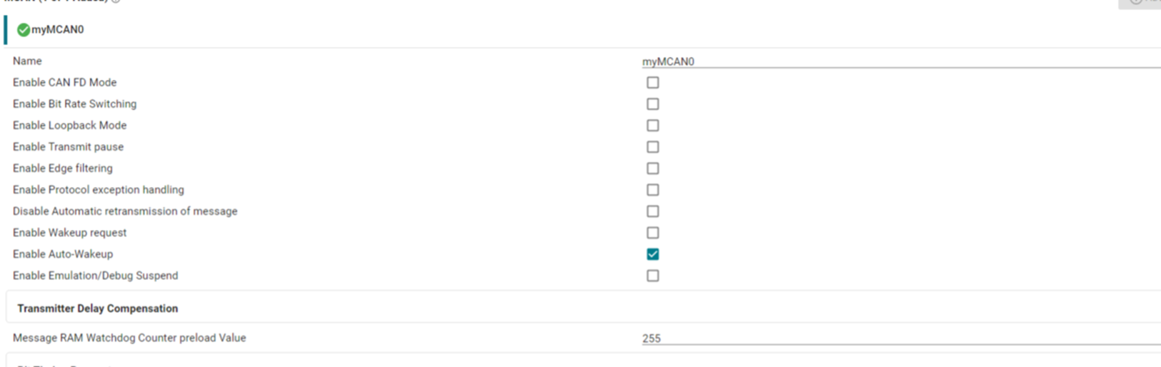

    Because customer don't use CAN-FD and extend ID filter, I change the demo to configurate the CAN is classic CAN, use standard ID filter: mcan_ex8_range_filter_receive.zip

  • In our demo: mcan_ex8_range_filter_receive, it isn't use the syscfg and can run normally

    3. MCAN_TDCR, but I don't enable the TDC, so I think is no matter
    It does matter CAN-FD. It is for TX delay compensation. Is TDC enabled in DBTP register?

    The RX FIFO1 new message, watermark, and Full (only one buffer in your config) flags are set. This means you have received a new message. it is expected, right?

  • The FIFO size is 1 in your config. Have you tried 2 or 3 of FIFO size?
    am not sure if it is a bug or not, MSI=b11 is not used anyway.
