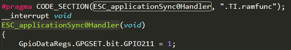

attacched in the below picture is shown the delay, plotted in an istrogram between the arrival of the interrupt trigger (in particular a ECAT SYNC0 signal, routed with the OUTPUT XBAR in a GPIO) and the first istruction be executed inside the ESC_applicationSync0Handler (set a GPIO).
My question is about the extreme jitter of about 500ns (100 istructions @ 200MHz), can it be consider normal? My problem is not of the delay itself but it not being constant.
Please note that this is the only interrupt active and it's executing from RAM.

    Also i know that context save/restore can take variable time depending on the context, but it can really jump from 250 to 550 ns delay? So 300ns jitter (Sorry in the beginning i wrote 500ns).
  • I have looked at the disassembly, from the beginning of the ISR to the GpioSet istruction there are 24 instructions. So 16 that you mentioned + 24 = 40 -> 200ns. Now in the picture we can see that normally the code ISR is delayed of about 225ns. This is consistent considering also the Gpio set instructions and the actual GPIO dynamic. Still the variation of more than 300ns = 60 instructions is not clear.
  • Hi, I've found the problem. The problem is the auto-generated ECAT stack code, in particular during register access.
    basically every time that the ESC read a register it disable all interrupts causing the jitter that I've shown you. Since this part causes a delay of even the SYNC0_ISR it seems that there are problems with the ECAT stack.
