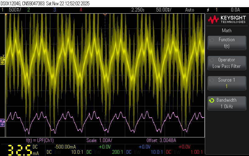

I am working on running an HVLS PMSM fan motor using the TIDA-010265 reference design (hardware + software).
Motor specifications are:
Max speed: 22 Hz
Rated current: 1.3 A
Power rating: 280 W
During my testing with load, I am facing the following issues:
Overcurrent fault at startup:
Most of the time, the motor hits an overcurrent trip right at start. Occasionally, it ramps normally. -
Vibration during rotation:
Even when the motor ramps up properly, there is noticeable vibration in the rotor during operation. -
Cannot exceed 17 Hz:
The motor reaches around 17 Hz, but when commanded beyond that, the overcurrent protection (set at 1.3 A) triggers every time.
These issues occur with both the FAST estimator, and with FAST + eSMO enabled.
I have attached the phase current waveform in this post for reference.(Waveform captured at 15Hz speed)
What could be the root cause of these startup overcurrents, vibration, and inability to reach the rated 22 Hz?
