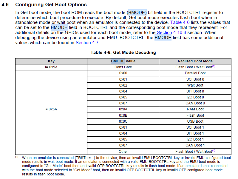

TMS320F28377S: SCI boot mode - GPIO selection for SCIA TX and RX
Part Number: TMS320F28377S
SCI boot mode (GPIO72 = 0, GPIO84 = 1 during boot)
We'd like to assign SCI_A_RX and SCI_A_TX to GPIOs 28 and 29.  SPRS881J indicates that this is possible with the SCI-Boot1 selection. See table 8-14 below. The Technical Reference Manual indicates that BMODE = 0x81 selects SC-Boot1, but describes this as a seletion that applies to the Get boot mode. Table 4-6 below.
Does the BMODE setting also apply to SCI boot mode ?
