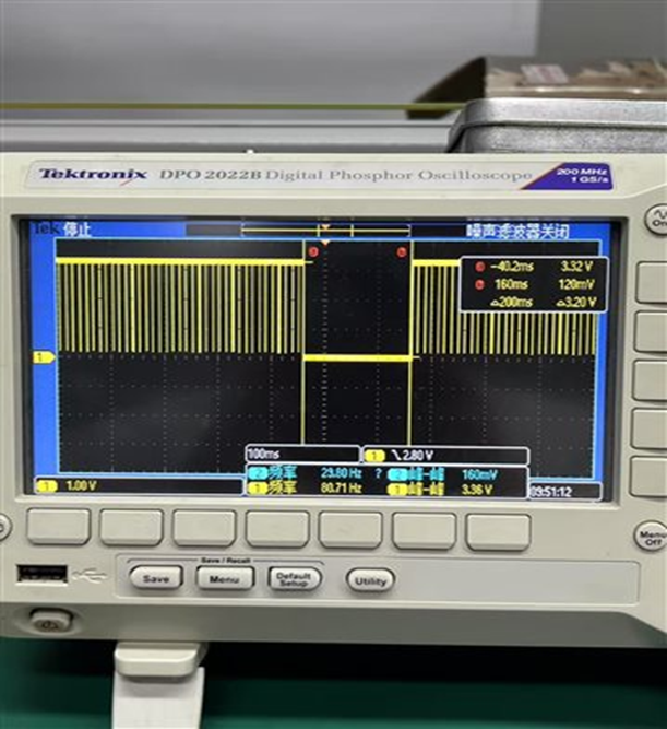

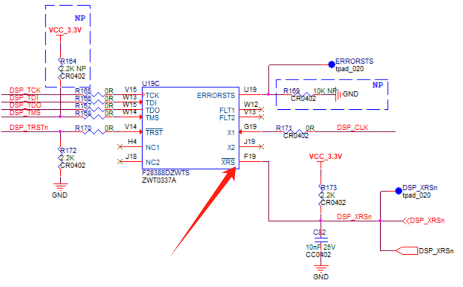

2)After the board is powered on, the chip frequently undergoes automatic reset, causing the program to fail to run normally. Measure the XRSn pin of the DSP chip, and the detailed signal waveform is shown in the following figure
Figure 2 DSP XRSn signal waveform diagram

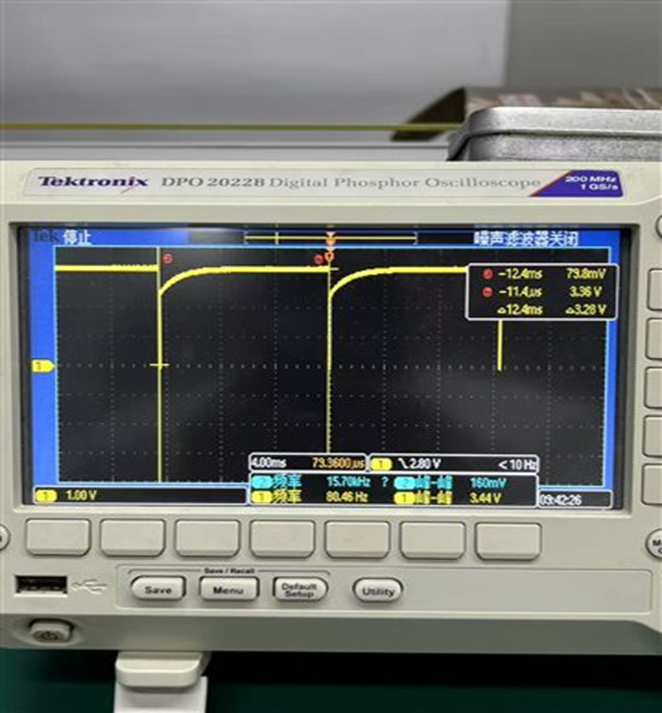

3) After forcibly lowering the XRSn pin of the DSP chip, the board still cannot start and the fault has not disappeared. The waveform after measuring and lowering the XRSn signal is shown in the following figure:

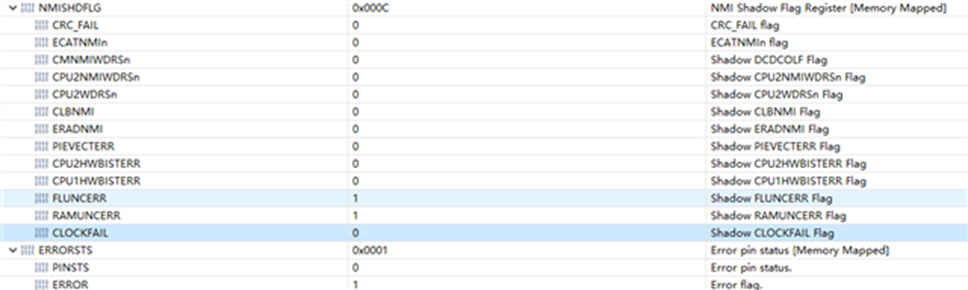

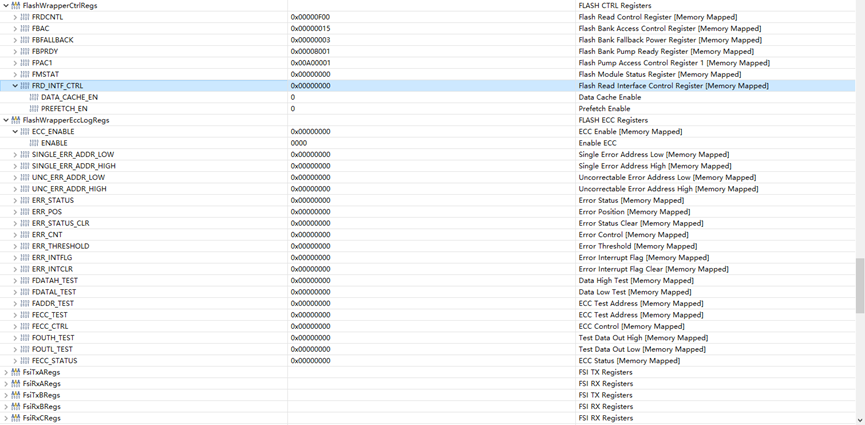

5) Connect the simulator to the faulty board B and use the debugging function. After the chip is started, it cannot enter the program that has been programmed and solidified. At this time, the status of the registers is as follows:
6.By analyzing the registers,it was found that both FLUNCERR and RAMUNCERR are 1, causing the board to continuously trigger NMI and reset. Further examination of the status of the PREFETChEN register revealed that it has been disabled, and upon checking the UNC-ERROADDR-HIGH register, it was found that the address is 0.

    Can you confirm the NMISHDFLG reading for all boards that are failing ?
    Can you modify your NMIISR to clear the flags and put a while loop in the NMI ISR so that the NMIWD doesnt timeout and its possible to debug the rootcause of the NMI trigger.
