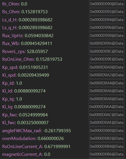

I’m currently testing our custom BLDC motor using TI’s Universal MotorControl Lab, and I’m encountering an issue with Hall sensor-based control.
The hardware in use is LAUNCHXL-F280039 and BOOSTXL-DRV8323RH.
At Build Level 4, when driving the BLDC with Hall sensors, the motor intermittently stops once it reaches speeds above 50 Hz.
Additionally, when issuing a 0 Hz speed command, the controller becomes unstable and diverges.
Motor tuning has been completed, and under exactly the same conditions, when using FAST, there are no issues at all.
The Hall sensor signals have also been verified as normal, and with other Hall sensor-based solutions (e.g., ST), there were no problems during operation.
Hall sensors A, B, and C are connected to Launchpad pins 2I, 2B, and 2A, respectively.
It has been confirmed that phases B and C are delayed by 120° and 240° relative to phase A.
I also attempted Hall sensor calibration using HALL_CAL, but it made little difference.
Do you happen to know what might be causing this issue?
Below are the main parameters of the motor and controller, as well as the Hall sensor tuning results.Motor_Controller_Params.png
