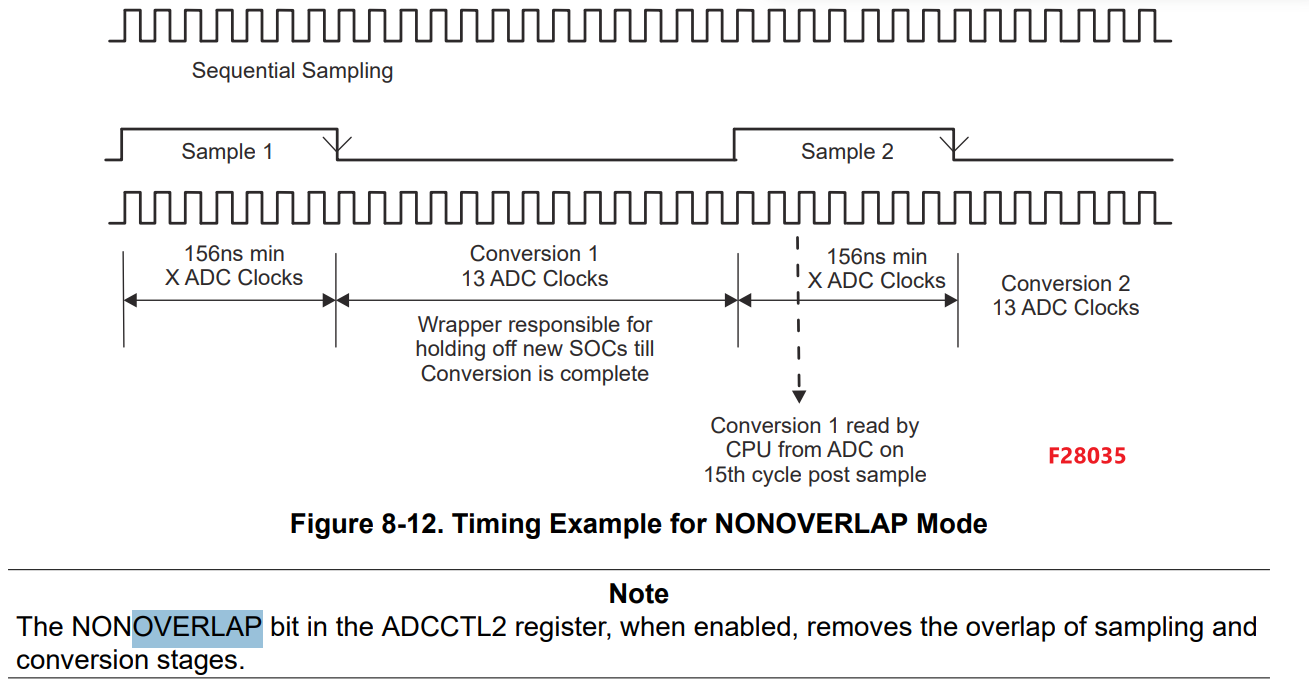

F28035 support ADC overlap, but F280049 don't have this mode, what cause this change?

F280049 and F28035 use different ADC wrappers and this feature is not available in F280049 design. Is customer doing a migration from F28035 to F280049? If so, they can emulate this in software in that at end of 1st sample conversion, transfer the ADCRESULTS register contents another RAM memory and when 2nd conversion starts, trigger a CPU read to the RAM memory where the first sample waw written to.
