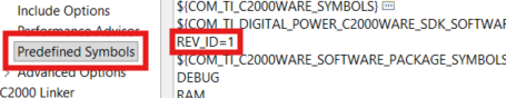

    Which REV LaunchPad is being used? If using REV0, you will need to add REVID_REV0 in the predfined symbols, or else the device_cal function will fail. More information in sysctl.h.

    I have checked the launchpad. The launchpad is a MCU133A version and the number is CL55240800021.  Is this a REV0 type.?
    I included the REVID_REV0 but the launchpad still has the same problem and hangs without stoping when I run it.
    Without the REVID_REV0, the cod does not run to the for (;;) loop and when I click on the stop button, stops at the position indicated in the snapshot I previously posted.

    MCU133A refers to CC built with Rev 0 Silicon, so you will definitely need the REVID_REV0 in your program. If I'm understanding correctly, after adding the predefined symbols, you're able to run to the for(;;), but it is still pausing at the SysCtl_setClock(uint32_t config).

    Thanks you for the reply.  I have tried the suggestions but the launchpad still get stuked at start up and does not run to the while (1).  The results of the suggestions are below
    1. When I include the REVID_REV0 the code did not link as there was no symbol for device_cal error.  That means that is not the solution.
    For MCU133A version, you must use this predefined symbol. Please rebuild the project, not just build the project LAUNCHXL-F28P55X: CPU crash when calling device_call function

    All MCUs that start with "X" such as XF28P550 are revision 0, REV0. Therefore, in your predefined symbol you need to add REV_ID = 1 or REVID_REV0, either works.
    If you use F28P550 then it is REVA version. It should be set by default, but in case it does not work you could predefine REV_ID = 2 or REVID_REVA to be safe. Once you compile the project, please use "step over" feature in CCS and make sure that code steps over Device_init() function in main(). If it does not step over to the next line, the issue is still with REVID definitions.

    i.  Two LPs responded to REV_ID = 2.  The toggle gpio example blinked the LED when I set the toggle example gpio pin to 20.  However, when I try to run the example without debug mode the LED does not blink.  This is abnormal
    ii.  The others did not respond.
    I need a clarification.  By REVID_REVA, you mean I should REVID_REVA = 2 ?
    Thanks and I await your reply.
    You can just add REVID_REVA (REVID =2) or REVID_REV0 (REVID = 1) based on silicon on your board. REVID_REVA is set by default.

    REVID=1 and REVID=2 does not allow the code to build. The snapshot is below:
    REVID_REVA  builds but the code does not run.  It just hangs.
    REVID_REV0  The code does not build.  The snapshot is below:
