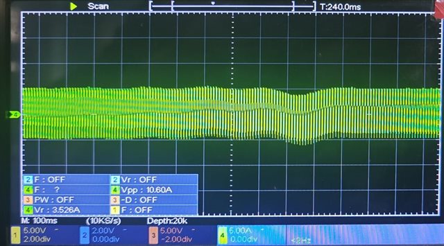

Hello Forms,
I tried to generate Variable Sine PWM Signals using ePWM Signals at 10kHz Frequency
Observations as Follows:
PWM Signals - 9.98KHz.
Dead Band (RED/FED) - 400ns
Vdc = 48V
Modulation Index = 0.01
Natural Frequecy (Set) = 25Hz
Natural Frequecy (Observation) = ~23.5Hz
ePWM Configuration used as Follows.

  • Hi Genatco,
    Thanks for the Response.
    ePWM signals are connected via a Gate driver(ST's - L6491D). We are Currently Using Infineon's - IPF016N10NF2S.
    Here is the schematic.
    Here is the Info Acc.to data sheet
    We previous tried to solve the above at 300ns but the sine distortion is Observed. I didn't tried to go Further in.
    After resolving the Angle errors sine Genration is Observed much Identical, but the Observed the Oscillations.
    Below are the Images, which are apart ~10sec and repeated after ~ 20sec
    Above Images are recorded at 0.01 MI with 100Hz NF.
    Soumitri.
