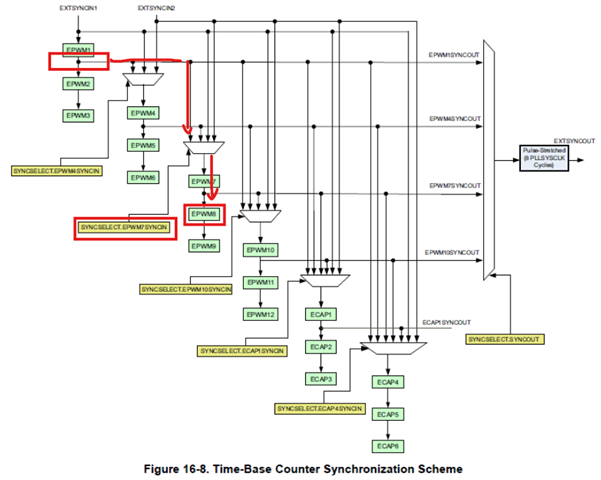

    Is it possible to phase shift and synchronize PWM1 to PWM8?
    Thanks and Regards,
    Prashant Gugle
  • Prashant,
    You could use following pipeline which would use ePWM1 output then set SYNCSELECT.EPWM7SYNCIN mux to 00 and then use EPWM7 syncout as EPWM8 sync in.
    There is a nice video on this C2000Tm enhanced pulse width modulator (ePWM): Time-Base Submodule that explains further how to achieve ePWM synchronization:
    https://www.ti.com/video/series/C2000-enhanced-pulse-width-modulator.html

  • Hi Stevan,
    Can we use CLB for PWM phase rotation?
    Thanks and Regards,
    Prashant Gugle
  • Prashant,
    Doubling of the duty cycle happens because there is a missed action while using the TBPHS register for phase shift. TBPHS register does not have shadow register, so shadow to active register transfer cannot be achieved as it is the case with CMPA/CMPB regs, which have shadow registers available.
  • Hi Stevan,
    In this example they are changing phase and frequency together. And they have discussed doubling of duty cycle , is something relevant for us hear?
    Leverage New Type ePWM Features for Multiple Phase Control
    Thanks and Regards,
    Prashant  Gugle
  • Prashant,
    You could also refer to this appnote for your application. It shows step by step instructions to configure global load one shot mode on sync event and how to avoid corner cases.
