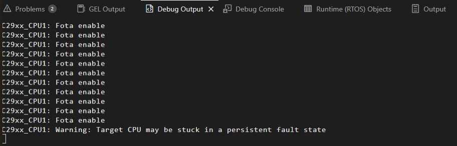

Iam currently working on creating a periodic task using DPL over freeRTOS.
  1. I can run a task without any delay like blink a LED without any issues.
  2. When i add the vTaskDelayUntil API the task hit vApplicationStackOverFlowHook due to task stack overflow.
  3. When i increased the stack size from the MCU stuck in persistent fault state.image.png
  4. While debugging the issue, the code reach this point and when i tried to step into it it happend that free running stuck Screenshot 2025-12-15 144325.png
  5. I tried the same code on core 3 and it works fine!
What could be the problem is?

    The issue with the "persistent fault state" is mostly due to the CPU being in the ISR when trying to reload the program. You can try resetting the board before flashing again.

  • Hi Mahmoud,
    I have looked into this, and there is no issue with using task delays inside tasks with/without DPL. This looks like some sort of stack overflow. Apart from the FreeRTOS stacks, can you also check if the system stack (symbol: __stack) is overflowing, and increase it if required. You can also check if your application code is making use of any RTOS elements before the scheduler has been initialized & started.
    Were you able to reload the program correctly after resetting? This is an issue when loading a program with the CPU in an interrupt context, and not specific to FreeRTOS. If you find that the program reaches the NMI ISR, you can also check the error aggregator status (Scripts > Error Handling > Error Aggregator > Check Status)

  • Hi  ,
    The MCU operates correctly after adjusting the stack size via SysConfig. Could you please share any documentation related to TI DPL and FreeRTOS for reference?
