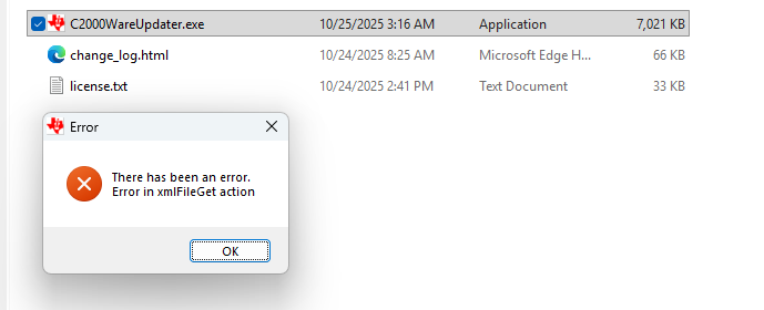

When I attempt to launch C2000WareUpdater.exe I get the following error dialog:
"There has been an error. Error in xmlFileGetAction"
C2000Ware_6_00_01_00

Is this a problem with C2000WareUpdater.exe or a something on my computer? I've tried 2 computers.
Hi
Sorry for the delay in responding to your question. There is an issue with the updater site that hosts the latest packages. Will get this resolved by tomorrow.

Question:
When I updated to 6.00.01.00 I had to manually update project variables that reference the C2000Ware paths.
Does the C2000WareUpdater do this automatically? or is there some other way ?
Thanks.
No, the updater doesn't update the variables that reference the C2000Ware paths.
This has to be done in the CCS project settings.
Best Regards
Siddharth
