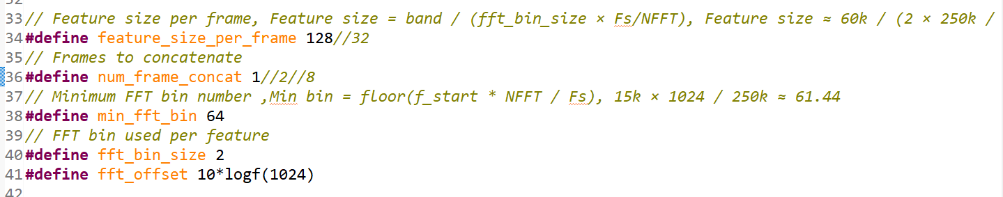

I am currently developing arc-fault detection software using the new F28P55 (28P55) device. While validating the solution with the document “Arc Fault Detection using Embedded AI models”, I encountered some difficulties in Section 7 (Integration and Verification of Arc Fault Application as a CCS project).
When I use the provided reference example (ml_arc_detection_F28P55x) for testing and verification, I can obtain the correct verification result, with
result.buf0 = [57, -40].
However, after replacing the model with the one generated by Model Composer, along with the corresponding preprocessing parameters, and then integrating, compiling, and importing the test vectors, the resulting result.buf0 does not match the Golden output. In other words, the verification fails after model integration.
I have tried generating new models multiple times, as well as new test vectors and corresponding results, but the verification still fails every time.
Could you please help explain why this is happening? I have attached the model I generated—could you help verify it?
classes.zip
_20251217-055614, ArcFault_model_1400_t_F28P55.zip
  • Hello Zhang
    The firmware is based on total of 256 features. If you are using 128 features per frame, then you need to to concatenate two frames. Alternatively, you can use 256 features per frame. I would request you to try the verification this way and let me know how it goes.

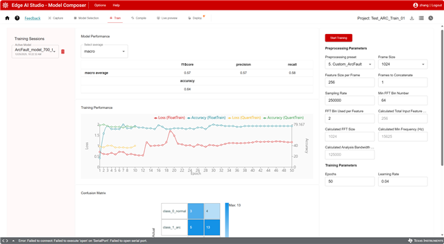

  • Hello Amir,
    Thank you for your reply and clarification.
    I have already tried using 256 features per frame, but unfortunately the verification results are still not satisfactory.
    To make the issue clearer, below are the main steps I have performed along with the corresponding outcomes:
    1. Training dataset used;
      4df212a0_dataset.zip
    2. Training results;
    3. Model compilation;
      _20251225-022527, ArcFault_model_700_t_F28P55.zip
    4. Updating the preprocessing parameters in the example project(ml_arc_detection_F28P55x);
    5. Replacing the test vectors in the example(ml_arc_detection_F28P55x);
    6. Replacing mod.a and tvmgen_default.h in the example project(ml_arc_detection_F28P55x);
    7. Final verification results.
    Despite following the above steps, the results are still not as expected.
    Could you please advise if there are any additional checks, configuration points, or recommended practices (e.g., feature scaling, frame alignment, window overlap, or verification methodology) that I should consider?
    Thank you for your support, and I look forward to your suggestions.
    Zhang
  • Hi Zhang
    The model training is not looking good. The accuracy should be higher than 95%. Can you tell me how did you get the training data?
    Thank you
    Amir Hussain
