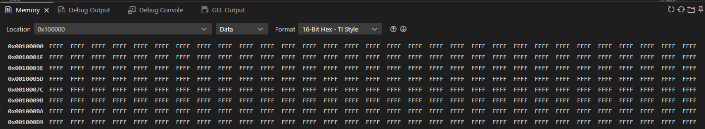

    1. I erased the entire MCU memory. The memory looks like this:
    2. I programmed our firmware, and it looks like this:
    3. This is how the memory looks before starting data programming:
    4. I carefully checked the entire Bank 4 using:
       a) Fapi_doBlankCheck
       b) Comparing all values in Bank 4 to 0xFFFF
       Both checks returned OK and the program continued without any issues.

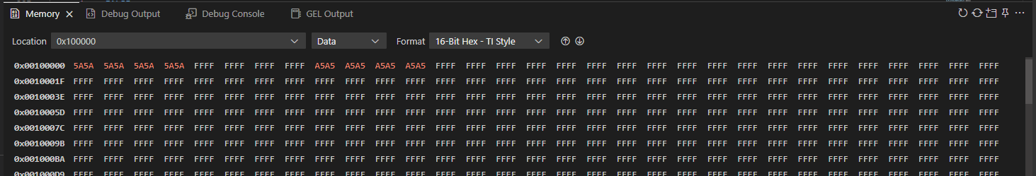

    5. I started the flash programming process:
    • The first 2 chunks were programmed correctly (0x100000 – 0x100007):
      Values:
      0x5A5A, 0x5A5A, 0x5A5A, 0x5A5A,
      0xFFFF, 0xFFFF, 0xFFFF, 0xFFFF
    • The next 2 chunks were also programmed correctly (0x100008 – 0x10000F):
      Values:
      0xA5A5, 0xA5A5, 0xA5A5, 0xA5A5,

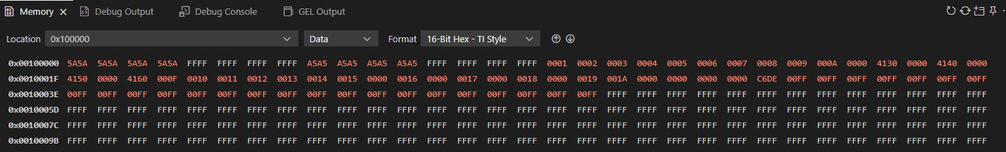

    7. When I tried to program the next chunk at address 0x100010, I got the same error as described before (0x101 (decimal: 257).
    The memory then looks like this:

    Based on your screenshots, the flash bank 4 ECC region is being written when you program your firmware onto the device. This is the origin of your FSM error. The first data segments may program correctly if their ECC codes match what is already present in flash, but when the FSM tries to program the ECC value to a different value it is unable to without an erase.
    Is any code or data allocated to bank 4 when programming your firmware to the device? Are you able to add an erase call just before reprogramming this region?
    Alex
