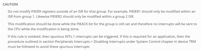

    This behavior is a symptom of using nested interrupts and the code modifies the PIEIERx register outside of a groupx interrupt.
    The caution on this page explains it:
    software-dl.ti.com/.../index.html

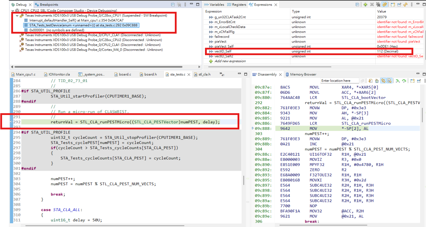

    Coming back to the original question: After multiple rounds of investigation, we did not find any code path that modifies PIEIER11 outside of the Group 11 ISR.
    However, I observed another important behavior. Before the unexpected triggering of the unregistered and non-enabled CLA1_1 interrupt, the function STL_CLA_runPESTMicro() returns 0x80 (STL_CLA_FAIL_SPURS_INT) several times, and only after that does the unexpected CLA1_1 interrupt occur.
    I then took a closer look at the behavior of STL_CLA_runPESTMicro(), which can be summarized as follows:
    1. DINT
    2. Disable all CLA tasks
    3. Wait for all CLA tasks to finish execution
    4. Run PEST
    5. Clear the PIE_O_IFR11 bits that are used
    6. Read all PIE_O_IFR11 bits; if any bit is non-zero, return 0x80 (STL_CLA_FAIL_SPURS_INT)
    In our application, CLA Task 3 behaves as follows:
    • Triggered by EPWM every 50 µs
    • Executes its task logic
    • Calls CLA_forceSoftwareInterrupt(CLA1_ONLY_BASE, CLA_TASKFLAG_3) to trigger the CLA1_3 interrupt to the CPU
    • Clears the EPWM event
    • Ends the task
    This led me to consider the following scenario:
    It may be possible that CLA Task 3 has already started executing before the CPU enters DINT inside STL_CLA_runPESTMicro(), and after DINT is executed, CLA Task 3 still calls CLA_forceSoftwareInterrupt().
    At this point, since the CPU interrupts are globally disabled (DINT), but the corresponding PIE_O_IFR11 bit is still set, there is no ISR to service the interrupt. As a result, when STL_CLA_runPESTMicro() later reads PIE_O_IFR11, it detects a non-zero value and returns the 0x80 error.
    To validate this hypothesis, I performed an experiment by commenting out CLA_forceSoftwareInterrupt() in CLA Task 3. After doing so, both the 0x80 error and the unexpected CLA1_1 interrupt no longer occurred.
    Based on this result, I would like to ask for your thoughts on the possible relationship between CLA_forceSoftwareInterrupt(), the 0x80 (STL_CLA_FAIL_SPURS_INT) error, and the unexpected triggering of the CLA1_1 interrupt.
    Any insight would be greatly appreciated.
    Norman

  • Norman,
    The CLA1_1 interrupt - yes, I feel you are on the right track.
    This occurs due to a race timing condition. If the CPU receives an INT11, it will "ask" the PIE for an group11 address to take the interrupt. Normally the PIE will respond with the highest group11 interrupt both enabled and flagged.
    If however, the PIE does not have a group11 interrupt both enabled and flagged, the PIE will default to the vector for first interrupt in the group. In this case CLA1_1.
    So, if the CLA interrupt "sneeks in" to the CPU side just before DINT takes effect, and then if the PIEIFR bits are cleared before the CPU asks for a vector, the PIE will find itself in this situation of no interrupt both flagged and enabled.
    Section 3.4.4.3 Disabling Interrupts of the TRM has some steps for disabling interrupts to avoid this situation.  Also how are you checking that all tasks have completed? The CPU can read the CLA's MIRUN register to check if any tasks are executing.

    And then I trying to review the TI library implementation more closely, I noticed the following behavior:
    • After completing a test, the function clears the PIE_O_IFR11 bit corresponding to the CLA task used in that specific test.
    • However, during the spurious-interrupt check, the code checks whether any bit in PIE_O_IFR11 is set.
    • If any bit is found set, the function reports a 0x80 failure (STL_CLA_FAIL_SPURS_INT).
    Based on this behavior, I believe the 0x80 failure occurs under the following condition:
    • During STL_CLA_runPESTMicro(), CLA Task 3 software-triggers a CPU interrupt after DINT, causing the corresponding PIE_O_IFR11 bit to be set.
    • If the current PEST iteration is not checking CLA Task 3 (for example, it is checking Task 6), then the function only clears the PIE_O_IFR11 bit associated with Task 6.
    • As a result, the PIE_O_IFR11 bit set by Task 3 remains asserted, leading to the 0x80 spurious-interrupt failure.
    To validate this hypothesis, I conducted an experiment where I logged which CLA task was under test when the 0x80 failure occurred.
    The results show that every time the 0x80 failure is triggered, the task being checked is not Task 3, which I believe supports the above analysis.
    I would appreciate your thoughts on this interpretation.
