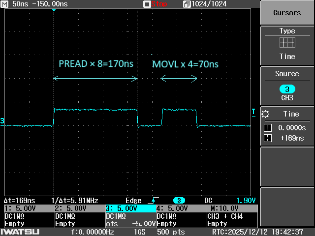

I measured the processing time by toggling GPIO13 while copying 128 bits of data from flash memory (Sector H: 0x0a1700) to RAM (LS5: 0x00ac00) using two different methods:
1. PREAD instruction: Reading 16-bit data 8 times
2. MOVL instruction: Reading 32-bit data 4 times
**Measurement Results:**
- PREAD: 170ns
- MOVL: 70ns
- Results were identical when reversing the execution order

**My Hypothesis:**
For MOVL instruction: The first read incurs wait cycles (3 cycles) for a total of 4 cycles, while subsequent reads hit the cache and take only 1 cycle each. Total: 5ns × (4+7) = 55ns
For PREAD instruction: The cache is not utilized, and wait cycles occur for every read. Total: 5ns × 4 × 8 = 160ns

    This is correct, and is due to how the prefetch is implemented.  Only instruction fetches will utilize the pre-fetch mechanism, so even though a PREAD is using the program bus, it will bypass the prefetch buffer since it is not an instruction fetch.
    As for the data cache, it is only valid for data bus accesses, and since the PREAD forces the read from the program bus, it won't be used here either.
    Is there a particular reason you need to use a PREAD in your application?  Since the memory map is unified on the C28x device, flash data is available to read on both the program and data bus freely.  As you have noted the fetch using PREAD is only 16-bits, so it is not as flexible as data space accesses which support both 16 and 32 bit accesses.
