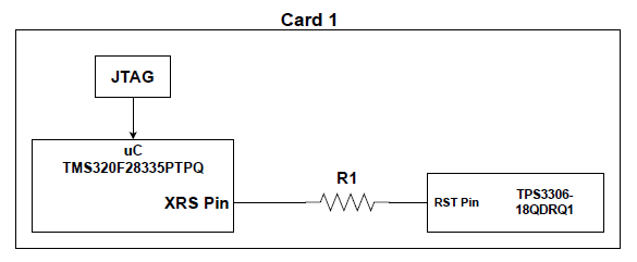

We are facing issue while programming the controller TMS320 through JTAG connections. For this we use 3 cards as you can see in the below attachment and our observation are listed below. Selected Flash Boot configuration mode for all operation.
First combination on Card 1.
Above Card 1 Combination is working fine  while programming the controller through JTAG.

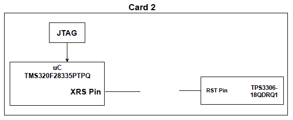

Second combination on Card 2.
Above Card 2 combination is working fine while programming the controller through JTAG.
Note: R1 is Open in Card 2 combination

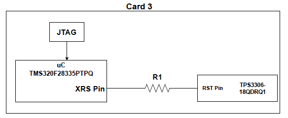

Third combination on Card 3.
In above Card 3 the previous combination of "Card 1" is implemented on card 3  and it is not working.
