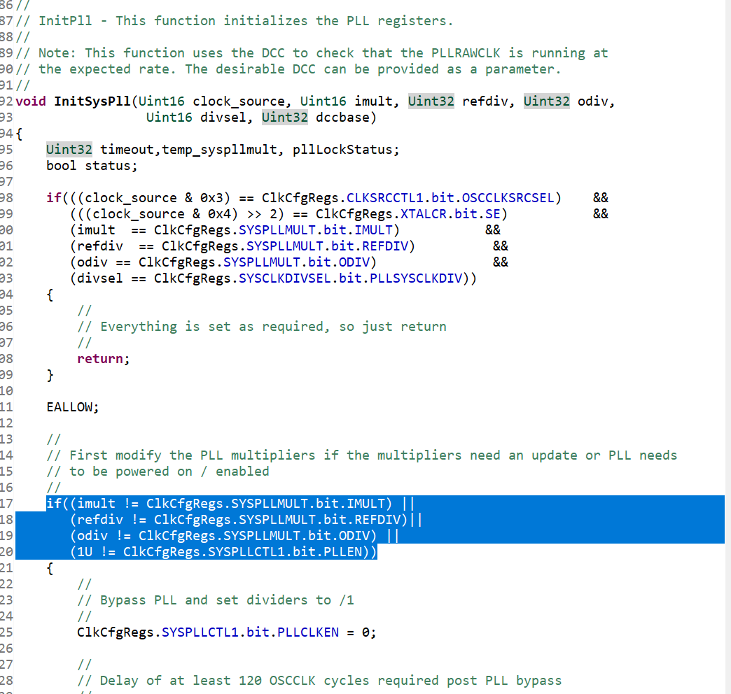

If I set the four parameters: imult, refdiv, odiv and divsel (as shown below for the InitSysPll() function) the same as the ones I used for the internal oscillator (48,0,1,1), which are actually their default values, I see that the InitSysPll() will configure the internal oscillator itself instead of the XTAL.
The reason behind this is that the switch-case to select the XTAL is within a if-clause that checks whether the four parameters: imult, refdiv, odiv and divsel have changed, and if they haven't changed from the default values, the code within the if clause is skipped altogether.

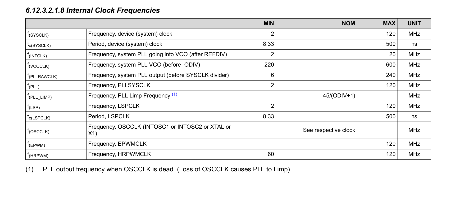

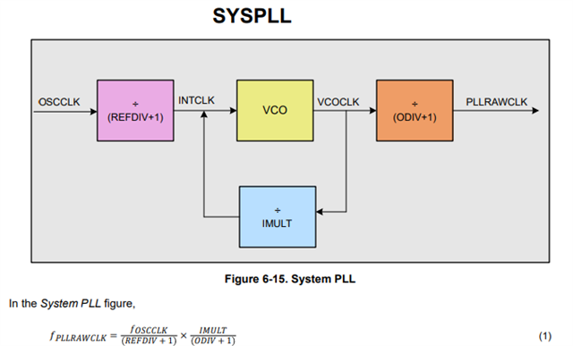

Here, in case a XTAL of 10MHz, and (48,0,1,1) is used for F28003x, the INTCLK is in the valid range. I have checked that for 10MHz OSCCLK, the INTCLK is 5MHz for refdiv = 1, which is within the range of INTCLK:
So, my question is this: if a user has a 10MHz crystal for use with the F28003x chip, and if the four parameters are configured to be the default values (48,0,1,1), which I believe comes from the bootloader that configures the clock to a default value, won't the InitSysPll() cause issues when trying to use XTAL, as the if-clause will be false and thereby the XTAL will not be selected?

    1. The way code is written now, it would skip the PLL clk configuration (switch clock source) and it would start-up with inherited PLL initialization and registers based on Boot-ROM programmed code.
    2. If the customer uses the same IMULT, ODIV and REFDIV as the internal oscillator, it will cause the code to fail to update the oscillator source to XTAL. You need to make sure that the coefficients and internal clock frequencies match the table provided. 6.12. Then, it would work fine.
