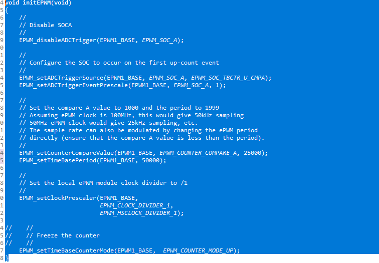

i wanted to know that what should be the excution time for adc
 adcStruct[AIP_IP1].adc_buffer = ADC_readResult(ADCARESULT_BASE, ADC_SOC_NUMBER0);
i am calling this in ISR ..which is triggered by EPWM trigger..
I get the excution time of 2.98 micro second..but i feel its two high..
attaching the settings for the same
  • sys configuration setting
  • Kindy reply asap..as i am trying to execute something

  • hello..i tried in the example code as well. There also this much time its taking?..i removed all the things from ISR..
  • I checked in the adc example code triggering multiple soc_epwm

  • I toggled the GPIO in this example code only the execution time is same only...
  • I had tried with one
  • i had tried with one adc conversion only..in the same example code

  • __interrupt void adcA1ISR(void)
    // Store results
     GPIO_writePin(myGPIO28,1);
    adcAResult0 = ADC_readResult(ADCARESULT_BASE, ADC_SOC_NUMBER0);
    // Clear the interrupt flag
    ADC_clearInterruptStatus(ADCA_BASE, ADC_INT_NUMBER1);
    // Check if overflow has occurred
    if(true == ADC_getInterruptOverflowStatus(ADCA_BASE, ADC_INT_NUMBER1))
    ADC_clearInterruptOverflowStatus(ADCA_BASE, ADC_INT_NUMBER1);
     GPIO_writePin(myGPIO28,0);
    // Acknowledge the interrupt
    Interrupt_clearACKGroup(INTERRUPT_ACK_GROUP1);
