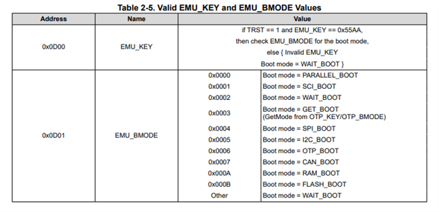

    Thanks for the detail, I thought we were stuck on a more fundamental scan issue, I mis-understood.
    In your code/setup you need to write to the EMU_KEY and EMU_BOOT registers so that the BROM knows to boot to flash, even though the emulator is connected.  When the emulator is connected (TRSTn = 1) BROM will look at the below to determine bootmode, vs the boot pins.  Else the device will enter into wait boot if the below doesn't match the expected contents.
    Matthew

    A writing to EMU_KEY and EMU_BOOT didn't solve my issue.
    The sequence below is done by me:
    1. Loading data to SRAM according to my application HEX file generated by CCS environment
    2. Writing _c_int00 value from MAP file to IC register (0x140)
    3. Writing 0x55AA to EMU_KEY register (0x0D00)
    4. Writing 0x000B to EMU_BMODE register (0x0D01)
    5. Running the core by writing 0x87FF to MF_REG_0
    Please your assistance.
    Edward
  • Edward,
    I would change step #2, instead of loading the C_int00 into the IC register directly, use the JTAG sequence to issue a CPU reset instead.  This should place the CPU PC at the BROM entrypoint instruction.
    Since you are loading a RAM image(apologies here, I mixed up that you were loading to flash, vs creating a flash loader), you should place your first instruction at address 0x0000(M0 RAM).  You can just use 1 32-bit word to hold a branch instruction to the rest of your code, likely in a bigger memory region.  Or if small enough you can place the whole code in M0.
    You will need to change the EMU_BMODE to "Ah" for RAM boot.
    There are some calibration steps that the BROM will do for you, so that once this calls your code the device will be configured correctly(oscillator calibrated, etc).
    I am not sure why loading Cint into the IC/PC isn't working, as that is what CCS would do for a typical load/run.  However, in that case CCS is going to invoke some instructions in the GEL file that take care of the fact that the BROM is not executed.  I'd like to avoid all of that with the Boot method.
    Let me know if this works and we can go from there.

  • Hello Matthew,
    My sequence now is:
    2. Issue core reset
    4. Writing 0x000A to EMU_BMODE register (0x0D01)
    5. Writing 0x0040XXXX to address 0 (0x0040 - LB instruction, 0xXXXX - address of my code)
    6. Running the core by writing 0x87FF to MF_REG_0
    I tried some 0xXXXX values, but it doesn't work.

  • Hi Matthew,
    The modified project didn't resolve my issue. I can't still execute it from SRAM.
    My sequence is:
    2. Writing 0x55AA to EMU_KEY register (0x0D00)
    3. Writing 0x000A to EMU_BMODE register (0x0D01)
    4. Writing 0x004091BE to address 0 (0x0040 - LB instruction, 0x91BE - address of .cinit)
    5. Issue core reset
    Is it correct?
    Edward
  • Edward,
    Can you try to remove step 4 and see if this works?  That step should not be needed, with the EMUKEY/BMODE writes we are doing in steps 2/3.
    Matthew
