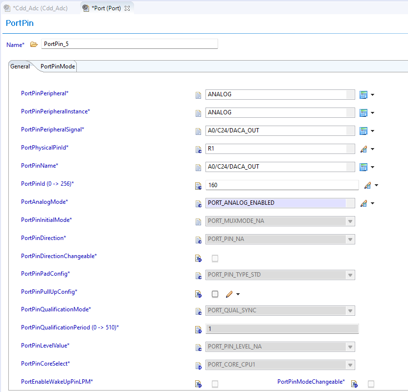

  • Hi Jenny,
    Since GPIO can only be configured by CPU 1, you can configure pins for all three CPUs in CPU 1. To configure GPIO you can use the PORT module from the MCAL. There is no need to use SysConfig for CPU, it has to be purely EB Tresos based config for MCAL.
    Configurations such as ANALOG pins exit in EB Tresos for CPU 1 MCAL:
    The same applies for ASYSTAL as well. Within the Cdd_Adc in EB Tresos, you can find the same options as SysConfig:
    All GPIO configs can be done in EB Tresos via CPU 1 and later used in CPU2/3.
