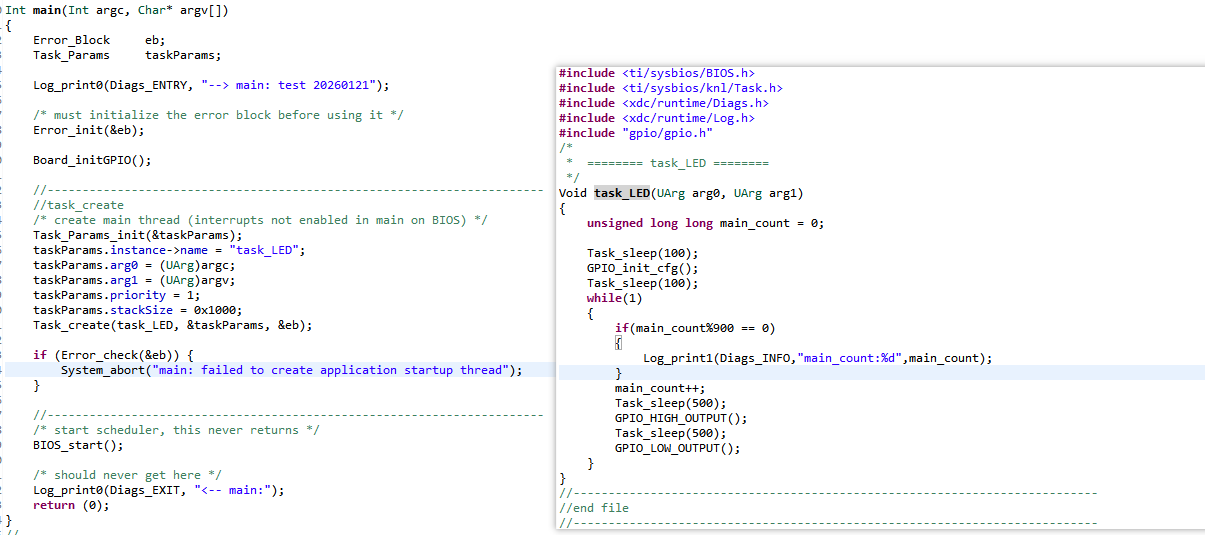

Hello, I am facing an issue with AM5728 on custom hardware and would like to seek your advice. Here are the details:
  1. I am testing on custom hardware using Linux remoteproc to run a DSP program. The DSP program's function is solely to control GPIO level toggling.
  2. After running for approximately 24+ hours, the DSP automatically restarts and reloads the program.

  • Yes, I have retested after disabling the watchdog in the device tree.
    Current observation:​
    The DSP no longer restarts, but the program itself also fails to run.
    Does this imply that the crash was actually triggered by an exception/fault within my DSP program, which caused the DSP core itself to crash?
    Below is the trace information.

    [    643.555] Exception at 0x9531de8c
    [    643.555] EFR=0x2 NRP=0x9531de8c
    [    643.555] Terminating execution...
    zzh
    This is what the logs show. Does this happen immediately? Or after some time?
    It would be worth while to investigate what is causing this internal exception at  0x9531de8c?
    You can inspect using ROV or by inspecting the code/map file.
    -Josue

  • Interesting. Keep an eye out for memory issues.. like a stack overflow or uninitialized variables.
    -Josue
