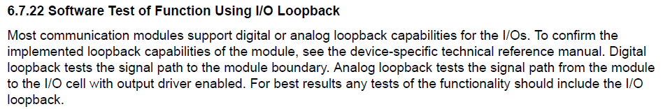

Currently, a product needs to comply with the IEC 60730 Class B standard. After downloading the C2000 Safety Automotive Industrial Package 3.01.00 and reviewing the documents "Implementing IEC 60730 UL 1998 Compliance for C2000 Real-Time Microcontrollers" and "Functional Safety Manual for TMS320F28003x Real-Time Microcontrollers", I have several questions regarding GPIO testing as follows:
1)For the 60730-H Section 7.1 Digital I/O testing, in addition to regular GPIOs, do PWM or APWM outputs via OUTPUTXBAR fall under the GPIO category?
2)Regarding the description of method GPIO4 below, I do not fully understand it. For example, if GPIO A is configured as an input/output , GPIO A outputs, and GPIO A is simultaneously read back and compared, does this comply with method GPIO4?

    The intent of GPIO4 is not the output latch. It is to verify the I/O function via a loopback observation at the input boundary, so you’re validating more of the real signal path than just a register value. Typical way to implement is to drive GPIO_OUT on one pin then physically wire it to a different pin configured as GPIO_IN and  compare expected vs observed input state.
    A single pin can’t truly be an independent input and output at the same time in the sense of two separate pins. While you may be able to read a pin status while driving it, that often collapses into you read back what the output driver is doing, which does not provide the intended diagnostic strength for loopback.

  • Hello expert, thank you for your reply. The first question is ok. The description of the C2000 Unique ID GPIO4 (as shown in the image from my first question) makes me confused about the 2nd question.

  • 1)Output I/Os: For I/O outputs, is reading back the same I/O status sufficient to meet the requirements?
    This depends on the design of your system and what is the function / failure mode / hazard of failure of this signal. Reading back from same GPIO will cover a lot of faults, but will not cover the complete signal chain, especially not covering package related fault. If you want whole signal chain coverage, then you will need to route the signal back into another GPIO for readback.
