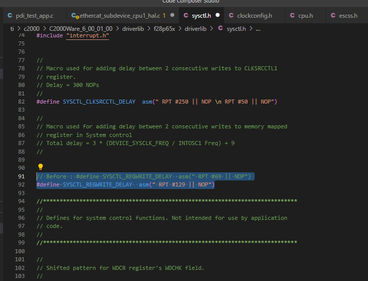

  • Hi sorry for the delay,
    This  issue was caused due to clock synchronization , increasing the delay solved this issue.
    Can you please change the delay in file : C:\ti\c2000\C2000Ware_6_00_01_00\driverlib\f28p65x\driverlib\sysctl.h
    Kunal.
