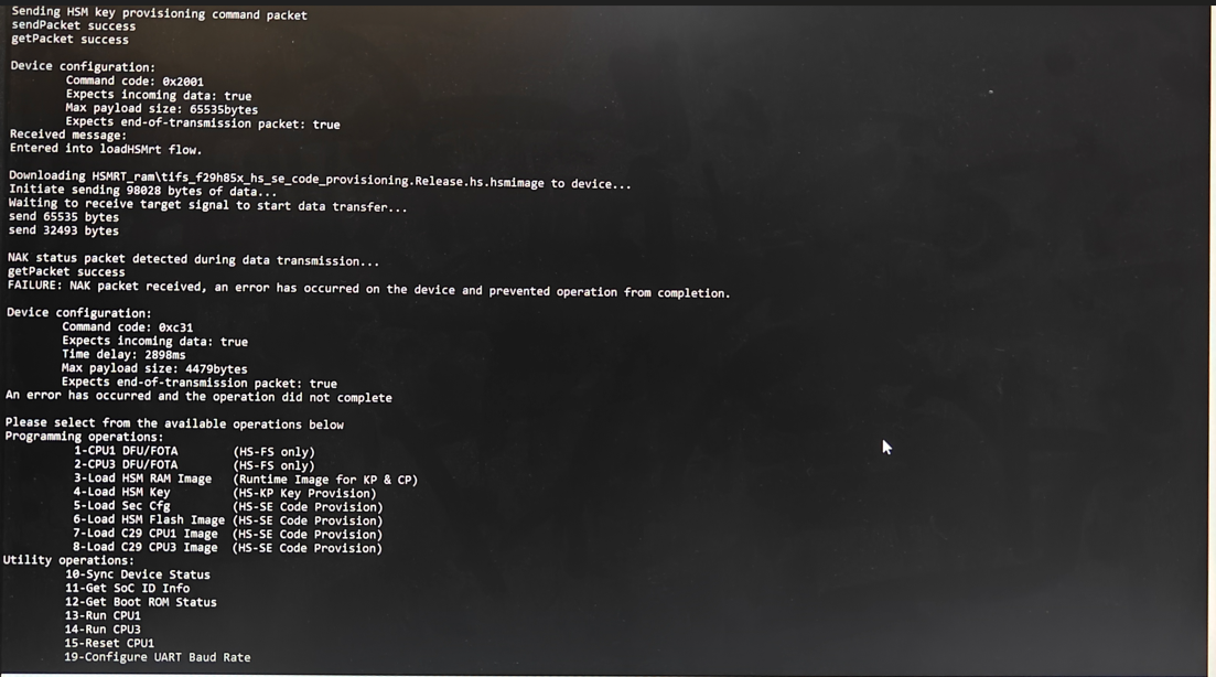

While trying to load the RAM-based HSM runtime (KP/CP provisioning HSM RT) using the RAM-based UART SBL, the SBL responds with a NAK after receiving the .HSMIMAGE. How can this issue be resolved?

The device is in HS-FS mode. After loading HSMrt, the HSM responds that HSMrt is not loaded successfully, even though there is no checksum issue.

Hi Shashank,
Which version of F29 silicon do you have? Could you also provide your versions of the TIFS SDK, the F29 SDK, and the OTPKW?

Hi Alex,
Device - F29h850TU9.
F29 SDK - f29h85_1_02_01_00
TIFS SDK - tifs_f29h85x_1_02_01_00
OTPKW - 10_1_02_01
Device on HS-FS mode, trying to load HSMrt firmware for code provision.

Hi Shashank,
Could you also provide the revision of the silicon? You can refer to section 2.3 of the F29H85x, F29P58x, and F29P32x Real-Time MCUs Silicon Errata (Rev. B) for a graphic on how to correctly identify it.

Hi Alex,
I need clarification on whether the application is written to flash after decryption. I need to check silicon revision of controller.
Shashank
For code provision we will use seccfg bin (available in tifs for each bank mode). Can user create seccfg.bin files?
We are currently using windows, command to create correct seccfg.bin for code provision flow.
What are the steps to create image for hs-se mode device, changing the keys path and device type in devconfiig.mak and imports.mak is enough?

Hi Alex,
Code Present on the controller - xF29h850TU9T ZEX 3L - 4ACi33w CL (there is no silicon revision character present).
