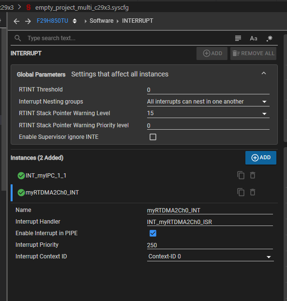

CPU1 interrupts on sysconfig
CPU3 interrupts on sysconfig
Whili CPU1 is waiting here, I'm loading the CPU3 symbol and I'm getting an error.
