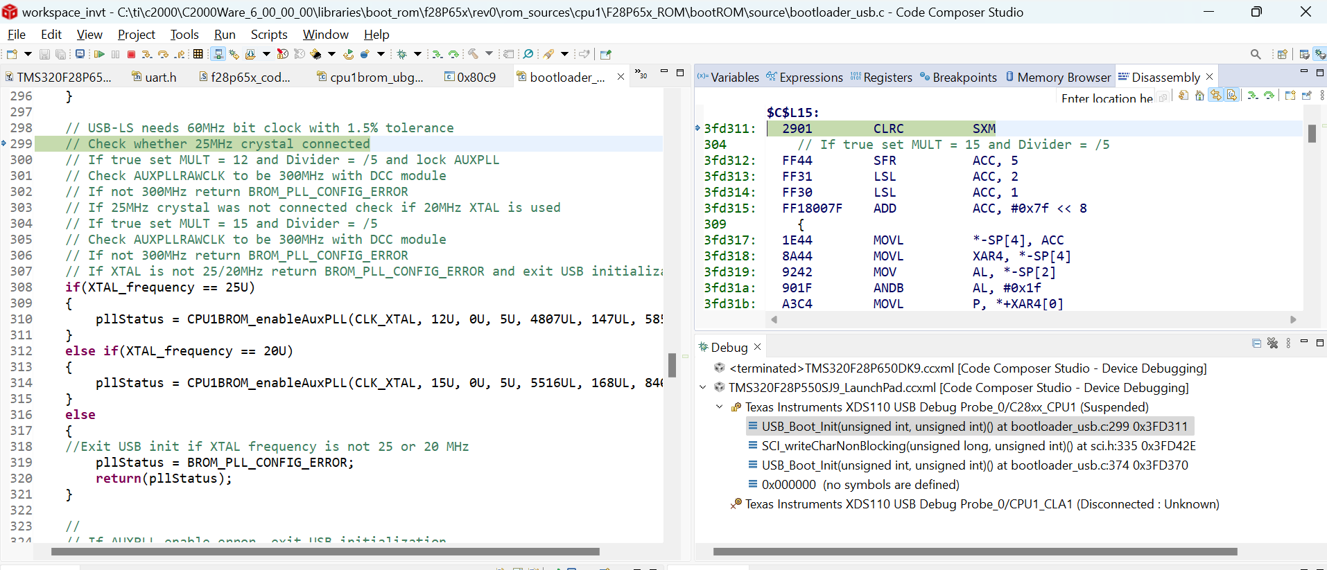

I find that the rom symbol does not match with the actual rom code.
A simple example is shown by putting a launchpad into USB boot and connects to CPU1 with GEL removed, and load the ROM sysmbol in C2000WARE 6.0, and click locate file and select the source folder.
As you can see, the sources halts at the comment instead of C code.
I can match the source and disassembly if I look carefully into the patterns in the disassembly, but this brings extra works and is very diffcult for someone who's not familar with the aseembly.
Is it possble to fix it?
